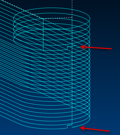

How can I tell QCADCAM to use a Tab only on one particular path and not on all stacked paths?
This example: I need to keep the lower one and get rid of the upper one. I think I tried all possible variation - none was working ... :oops:
What I'm missing? :(

QCAM simply adds a TAB (bridge) above Z final for each profile.
It further is not aware that the lower profile and the upper profile are stacked in X/Y.
Any next profile can be anywhere.
Using a bridge should be profile depending or a TAB should have a Z final specified.

Looks like the tab is applied to every in Z axis crossing profile - I'll address that in a bugreport.
Yes indeed.
Let's say a bridge needs to be 3mm high.
Z final of profile X = -9 => -6
Z final of profile Y = -18.2 => -15.2
Every profile stands on its own.
TABs are placed in 2D. Profile sources are 2D.
How should QCAM be aware that profile Y is deeper than profile X?
Simply solved with a profile property 'use tabs'.
Or with a TAB in 3D.

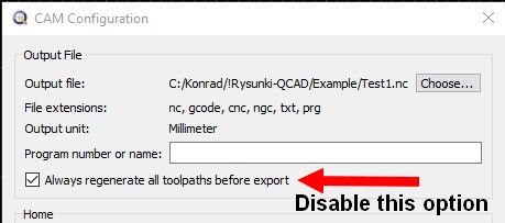

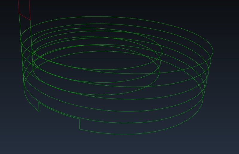

Here is the solution:
1. in CAM Configuration disable "Always regenerate all toolpaths before export".
2. Generate all necessary toolpaths except the last one - which has to have tabs.
3. Add tabs to your last path.
4. Generate the last path.
5. Press CAM Export.
See pictures below.

Re: How to avoid that a Tab is added to all stacked Tool paths?
Post by Husky » Sun Jan 16, 2022 11:37 pm
Great! Thanks for the tip!
