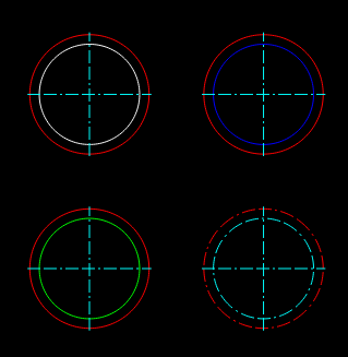

This example circle is one block inserted on different layer. You may play with it to see what you can do to control the attributes in a block.
blocks_and_layers2_mod.dxf
(101.78 KiB) Downloaded 530 times
