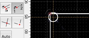

The easiest way in drawing an 'overcut' boundary corner is to construct a circle with cutter radius tangent to the boundary segments.
(Draw .. Circle .. 2 Tangents and Radius) (CTR)
Draw an auxiliary line between the circle center and the boundary corner.
(Draw .. Line .. Line from two points) (LI)
Move the circle with reference, choosing the intersection of the auxiliary and the circle as reference and the boundary corner as target.
(Modify .. Move/Copy) (MV)
Delete auxiliary line and trim where necessary.
This works for any enclosed angle between two line segments.
