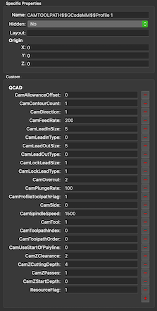

First, make sure that the property editor displays properties for blocks:
Edit > Application Preferences > Widgets > Property Editor > Display properties of current block and current layer
If you now create a toolpath manually using QCAD/CAM, you can see and inspect the special tool blocks and toolpath blocks that are getting created in the process.
Tool blocks are called "CAMTOOL$$[Postprocessor]$$[Toolnumber]" and toolpath blocks "CAMTOOLPATH$$[Postprocessor]$$[Toolpath name]".
Essentially, a fully automated process would have to create one block per tool and one block per toolpath with all the various custom properties attached to make the block a tool or a toolpath:
Block representing a tool:
Screenshot 2021-12-13 at 21.22.33.png (27.09 KiB) Viewed 15053 times
Block representing a toolpath:
Screenshot 2021-12-13 at 21.22.44.png (52.31 KiB) Viewed 15053 times
To generate the toolpath geometry, you could then call
Cam.regenerateToolpath(entityIds, toolpathBlock);
Where entityIds is an array of all entity IDs to be used for the toolpath and toolpathBlock is the toolpath block created to host this toolpath.
In a nutshell, that's the process a script could use to create tools and toolpaths fully automatically.
