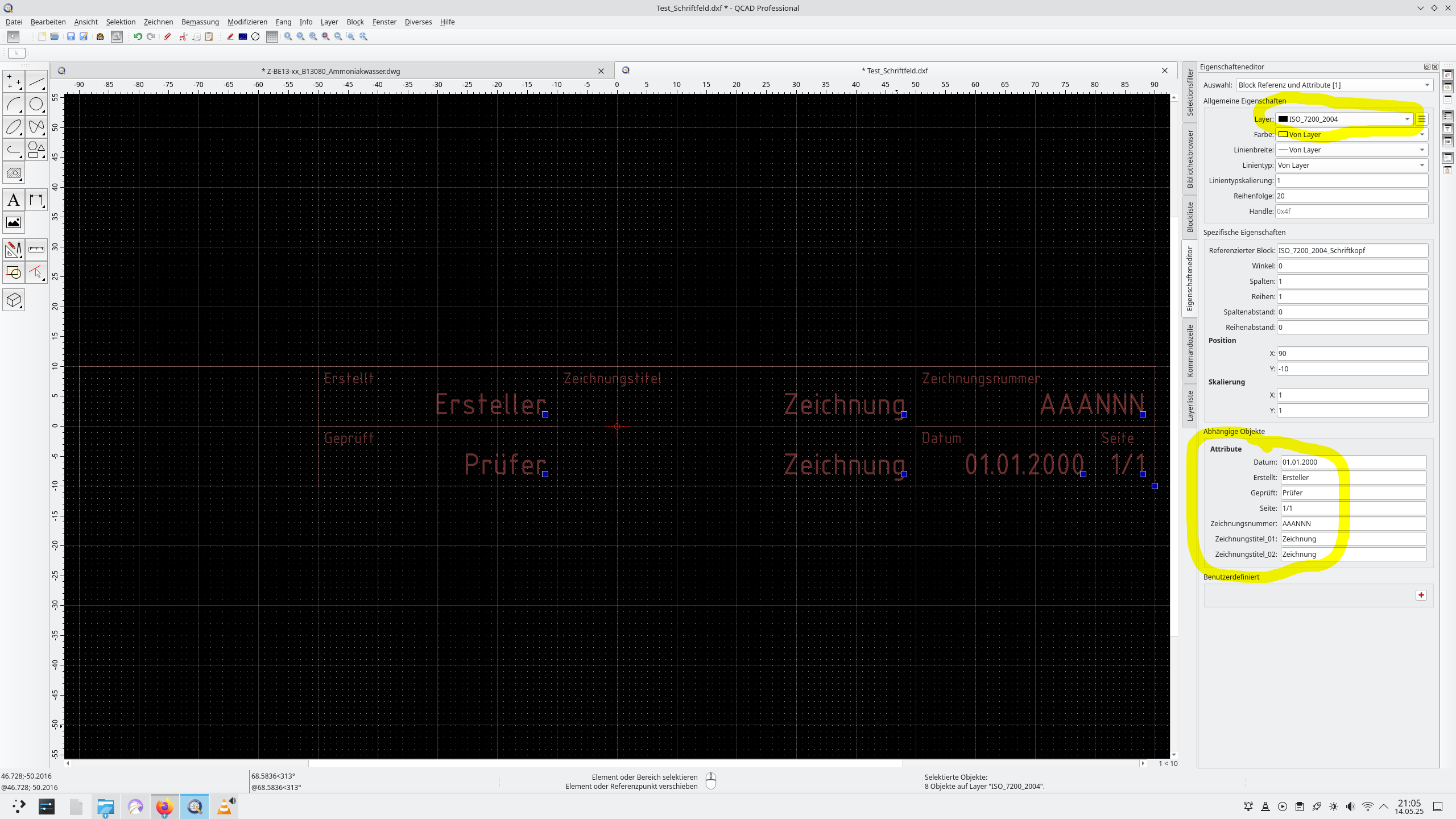

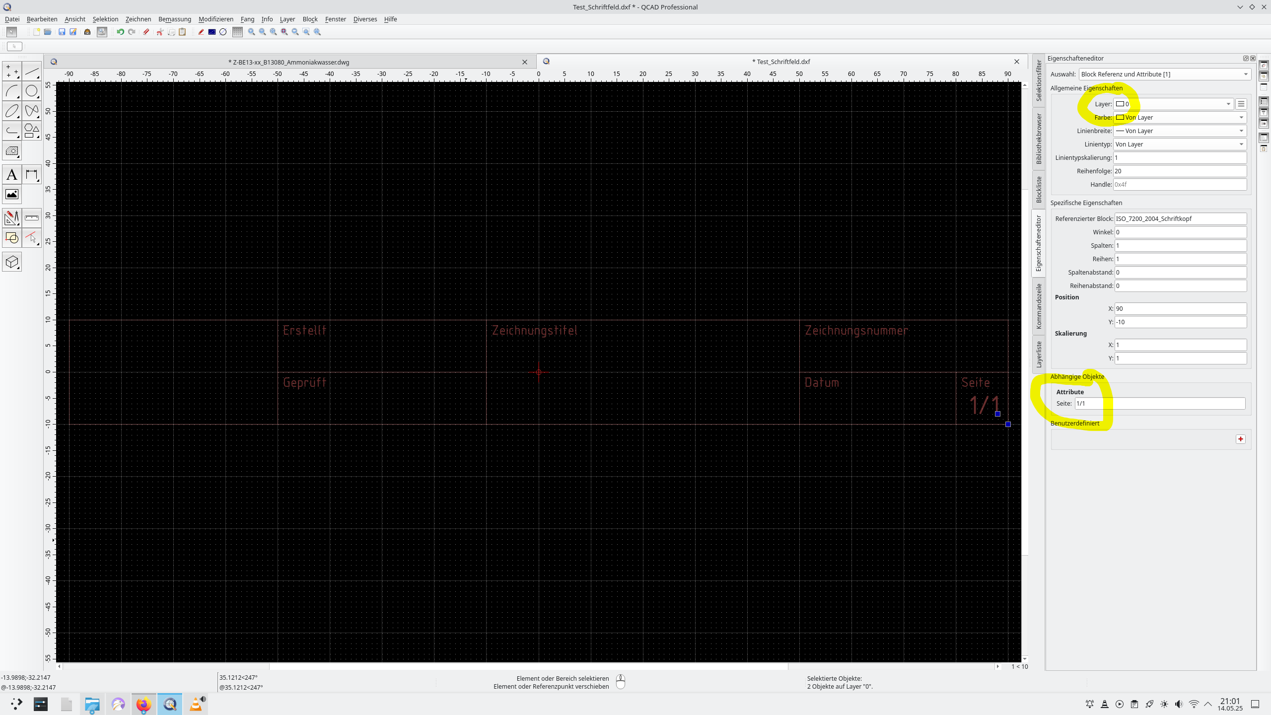

I have a drawing with block including 7 attributes. On saving I get an error message on command line telling me: "Exception occurred. Entity NOT saved: <ID of block>". When opening the file again there is only one attribute left in block reference. To reproduce the error I synchronized the attributes (shortcut "UA") and changed the attribute values via property editor. The problem persists.
I copied the block from original file into an empty file and still could reproduce the error. My observations:
1. Layer of block reference is changed to "0" on saving
2. The attribute that is left isn't always the same, when I reproduce the error
3. I could change few attributes without getting the error but after changing at least 5 attributes the error again occurs
Does anyone have an explanation for this error?
Stephan
file:
Test_Schriftfeld.dxf
(102.37 KiB) Downloaded 229 times
screenshot before saving:
screenshot after opening:
OS:
