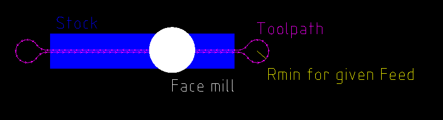

Solved this with a narrow, elongated but circular closed toolpath. :wink:
Adding semi circles or even somewhat larger circles and rounding at reversal point keeps feedrates up.
Simplistic representation
Even used a very flat ellipse style toolpath so that every axis is always in a certain smooth motion.
Although the toolpath is longer than dead stop and reverse, with a steady feedrate the fabrication time is shorter. :wink:
And ... The overall finish is considerable better.
Not supported by QCAD/CAM but you could alter the G-code to go down in Z for the main arc at reversal.
As if spiraling down instead of dead stop, down, continue.
In fact, I use a custom designed G-code macro where the round paths arc radii are related to the requested Feed and maxLinearAcceleration.
Path strategy can be enhanced for gradual engagement, chip thinning, best practice is considering specialized HEM toolpaths.

But even in the example, the tool only descends on one end. I do use this method for milling with a tool that is smaller than the work surface, but there is no need to mill in one direction when the tool takes the whole surface. Thanks for the reply.
It was a simplistic representation, a top view.
The arcs are exaggerated, they are calculated from the requested Feed and the maximum linear acceleration.
(My Feed value (mm/min) are usually at least tenfold the reciprocal of yours. :lol: )
As is, the toolpath spirals down for the two major curves at both extremities.
(I did mention that this is not supported by QCAD and requires to edit the G-code, simply add Z-nnn to the G2/G3)
The center of reversal is chosen so that the tool is not engaged when 'plunging'.
The first pass starts straight, the last pass is a finishing pass.
The actual center path is identical (drawn very close to distinguish the orientation of the arrows)
Took a while to get the G-code macro perfect.
Feed is dead constant for whole the toolpath from initial plunge to ramp out, beneficial for the surface finish.
Surprisingly, but then not, the fabrication time is shorter while the machine does not exhibit motion jerks.
