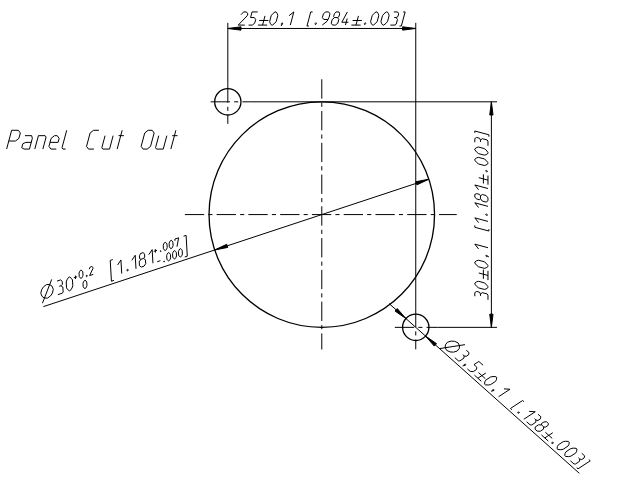

Post by iOne iTwo » Wed Dec 17, 2025 9:23 am
My favorite number is 2.54
This is a keep it simple request AFIK.
There's one set of length format tolerance display precision controls for metric.
There's a second set of length format tolerance display precision controls for imperial.
This is just asking to expose and display both controls.
The document's primary measuring would would control which gets displayed first.
How common is the need? Look at almost any technical data sheet. I will pick one at RANDOM. yep:
https://www.neutrik.com/en/product/nac3mp-hc
In a global market you are not doing metric or imperial. You are doing BOTH.
For today's bonus question: what units was this part designed for ?
