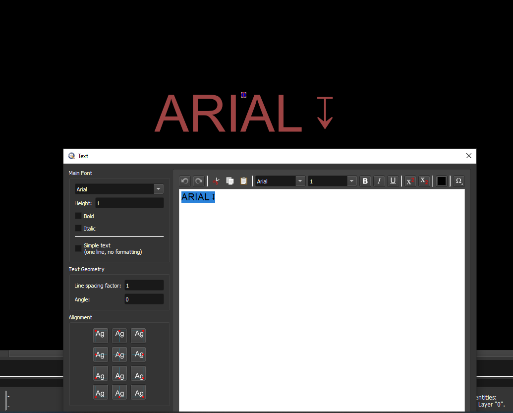

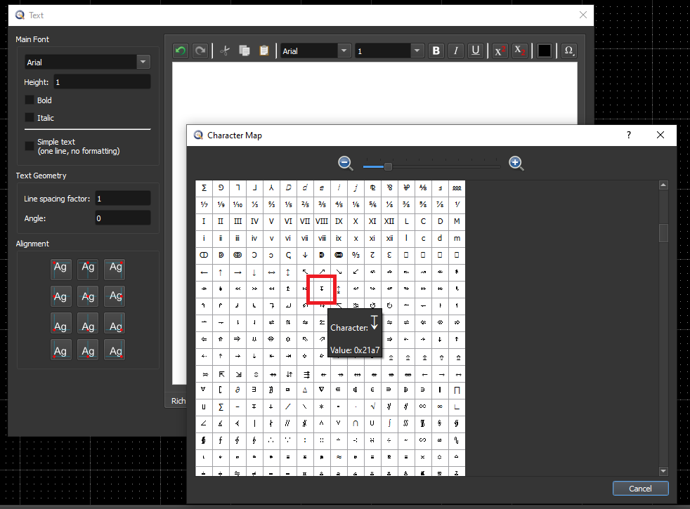

I am a little confused... I also do not see the plunge symbol when I look through the arial font on the Windows Character Map. So what am I seeing here in QCAD?
- arial 2.png (49.8 KiB) Viewed 16836 times
- ARIAL.png (39.76 KiB) Viewed 16838 times

I also observed that behaviour on Windows.
I think Windows does some kind of substitution. Presumably, this also happens in Notepad, Wordpad, right?

Can you elaborate on this, Andrew? Is Windows causing the substitution within the QCAD text editor? Are you saying that's why I can see the plunge character even when supposedly in the Arial font?

Re: "Depth of plunge" symbol?
I'm not a Windows expert but that's how it looks like to me. Try the same thing in Notepad, Wordpad, etc. the glyph will show up even if you are using Arial. It's unrelated to QCAD.ryancousins wrote: ↑Mon May 23, 2022 2:05 pmCan you elaborate on this, Andrew? Is Windows causing the substitution within the QCAD text editor? Are you saying that's why I can see the plunge character even when supposedly in the Arial font?

Okay. So it is the OS that populates the "Character Map" that pops up when you choose "other" in the QCAD text editor window?
To be precise, it's the OS that renders the glyph "↑" in font "Arial" onto your screen when the character map is shown, or when you type that glyph into the text dialog or when QCAD renders it as part of a text entity in the graphics view.ryancousins wrote: ↑Mon May 23, 2022 4:10 pmOkay. So it is the OS that populates the "Character Map" that pops up when you choose "other" in the QCAD text editor window?
