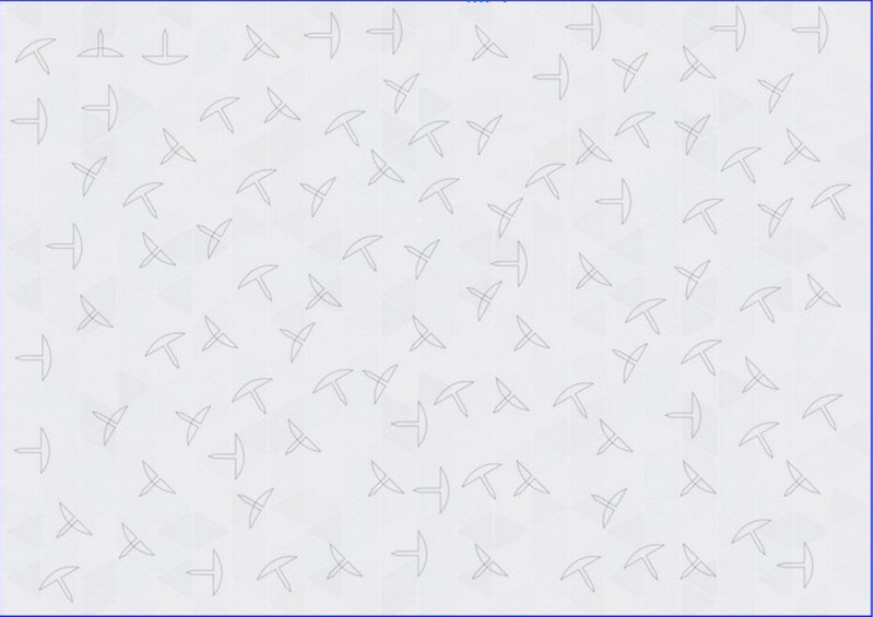

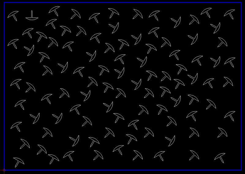

Okay here's my test with this and a few important notes:
1. This is a drawing with 101 thumb tacks I wish to laser cut. 2.After exporting the file to SVG in QCAD the first result is not good, as you can see 'SVG Nest' doesn't like Arcs or Splines
You can see that some of the thumb tacks have the 'domed' head inverted, these are the ones which are splines.
The domed heads which look good are arcs ... but you have to change the whole of the outline to a polyline in QCAD in order to get this result ... if you don't you will get the inverted result!
*Note - if you try to work with a spline and change this to a polyline it doesn't work either (not for me anyway).
3.So currently for the best results when using SVG Nest, use lines, arcs and change to a polyline .. or of course just use polylines in QCAD. The result worked for me.

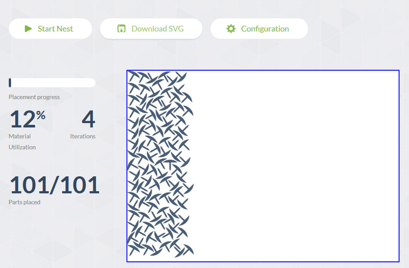

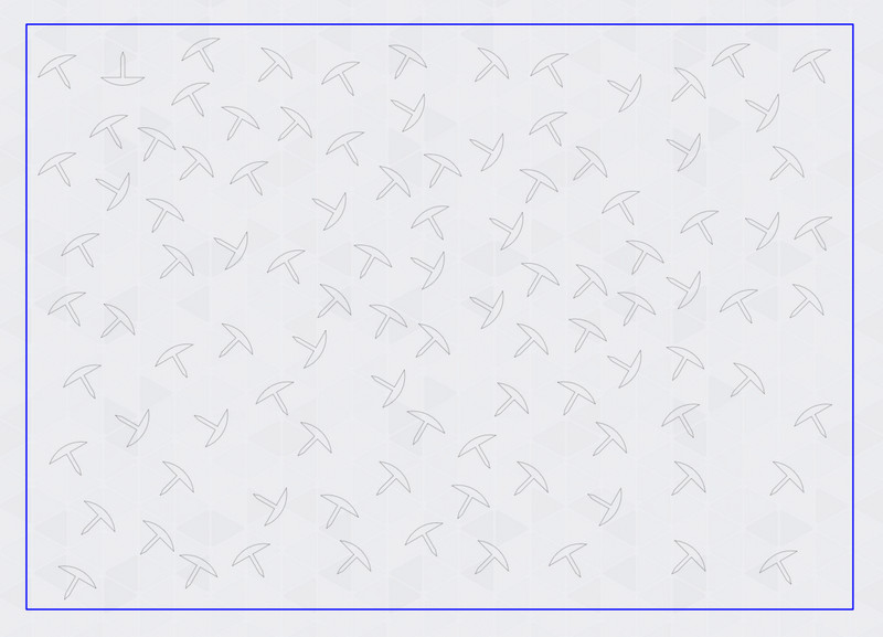

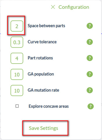

4.Next, export to SVG in QCAD and upload this to the SVG Nest program. Follow the instructions (so simple) and change the configurations as required.
5.This is the result after 4 iterations. Not bad hey

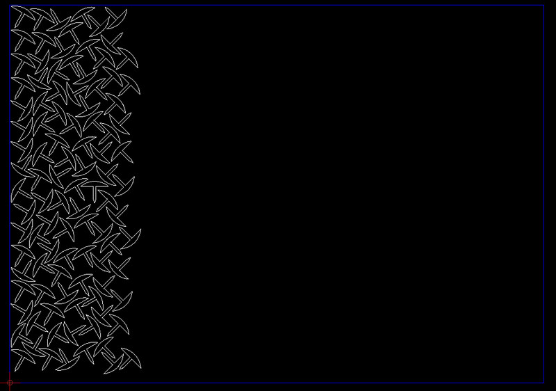

6. Then download your nested SVG file and open up in QCAD and job done

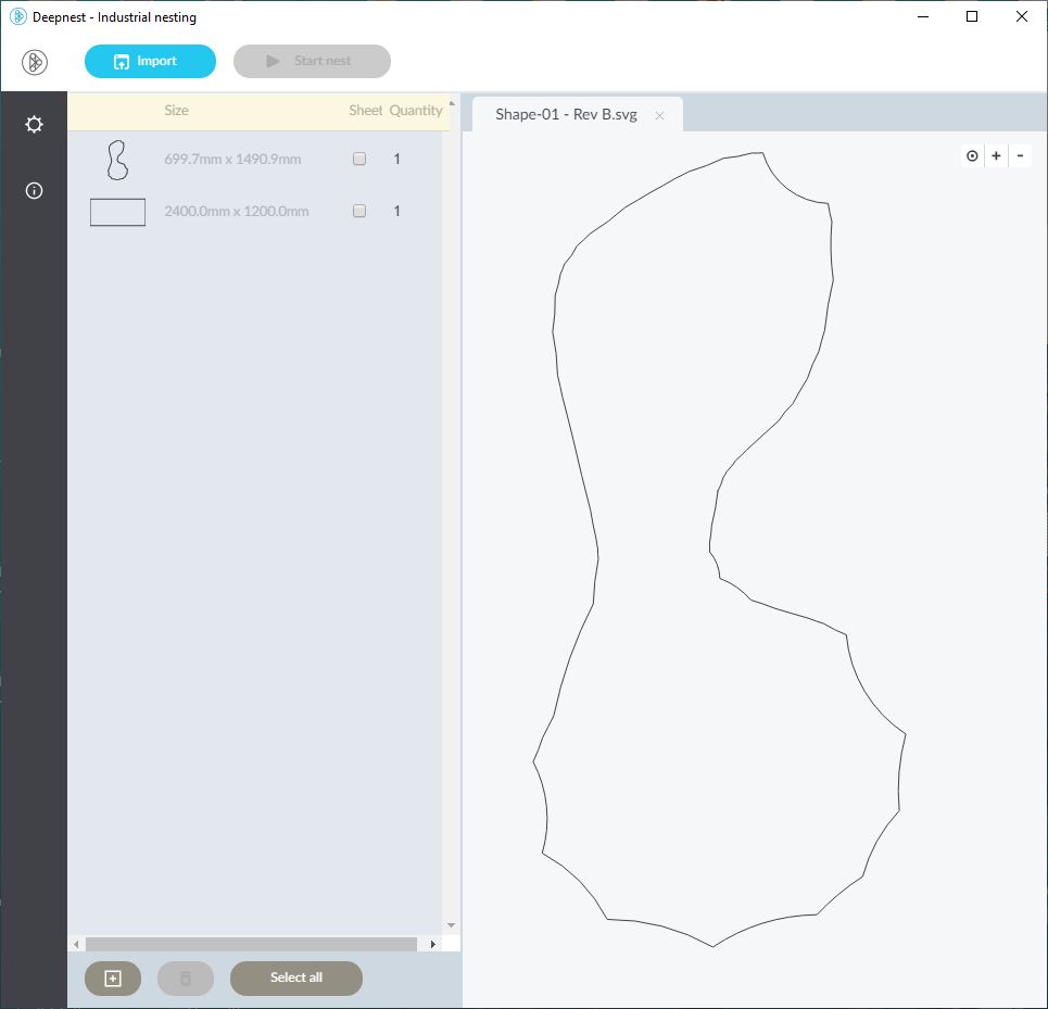

Just tested with quite a few parts and it worked great, apart from this file, somehow it seems to of reversed some arcs? any idea what might be going on... it's in metric, was going to nest on a 2400x1200mm sheet...see picture and attached file..
