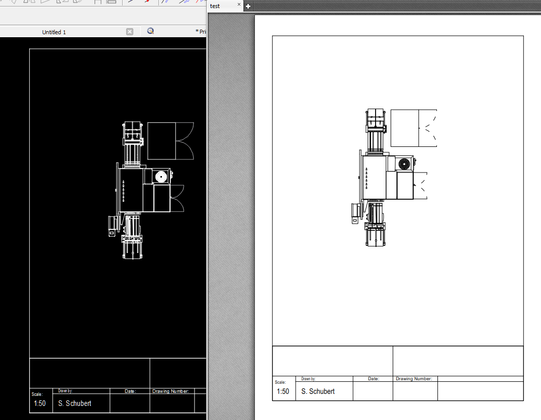

Another strange behaviour is that I get an arc with missing parts (linetype ISO) after a PDF export (with the built in tool). When I change the arc line type to hidden I get a complete arc after PDF export.....

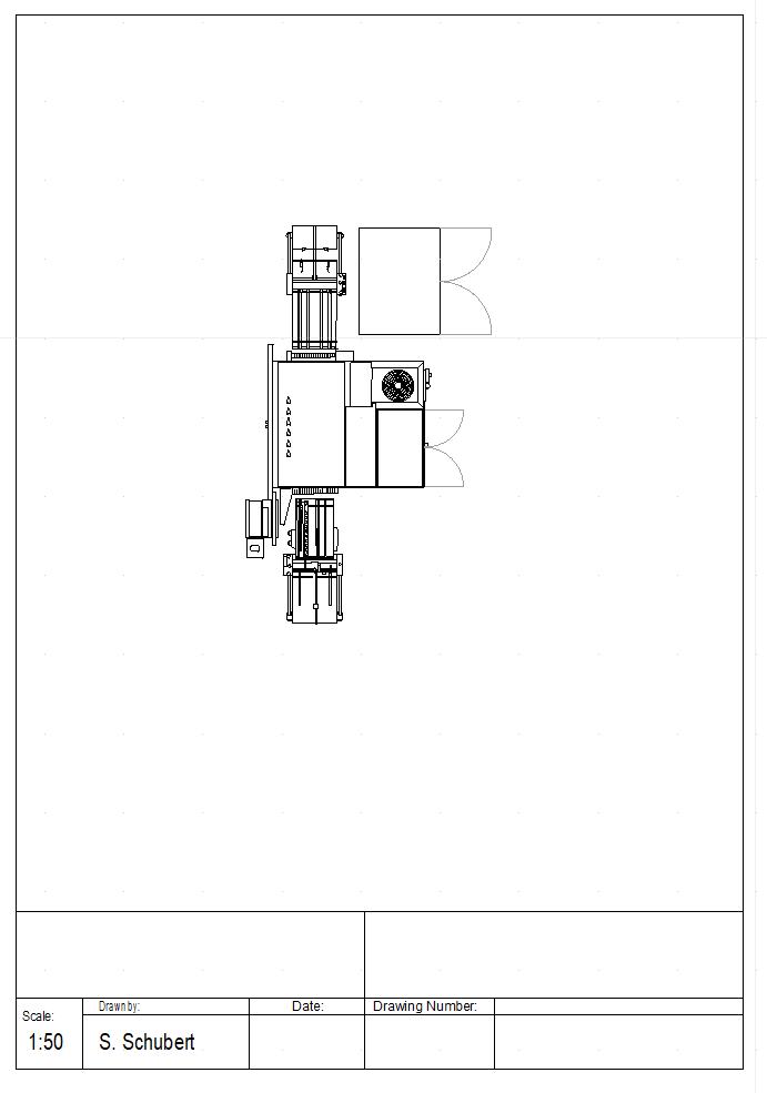

Screenshot how it looks like in CAD
CAD Drawing

Sometimes I have some missing lines, dots, text, etc. in a printout. I have the same missing bits and pieces when I do a PDF export by using the print dialogue and the Microsoft PDF writer.
What exactly is missing? If I compare the QCAD drawing with the QCAD pdf result I can't really see what is wrong.
Edit: Ok, I see. I didn't test it with the Microsoft PDF writer.

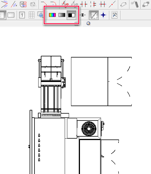

Howsoever: What is your print color mode? Full Color Mode or Black / White Mode?

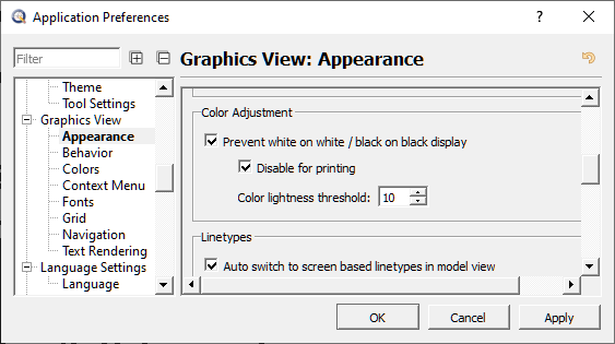

Application Preferences / Appearance is set to Color Adjustment: "Prevent white on white / black on black display" - works nice in Model_Space.
Additional the Appearance is set to: "Disable for printing"
The user prints in "Full Color Mode" and the entities on the white layer disappear. Why? You can't see a white on white entity ... :(

I think (still not 100% sure) your wild guess is right. However, difficult to understand the secrets behind.
I was never paying attention to the setting prevent white on white and black on black so this is activated and unfortunately I was creating some bits and pieces in white on white but never realised it as I got them displayed in black....
