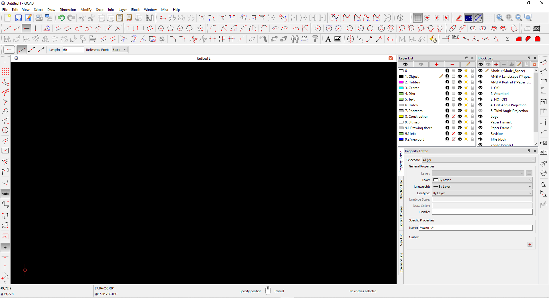

I assume my GUI arrangement demonstrates what kind of tool box is handed to you by QCAD Pro
