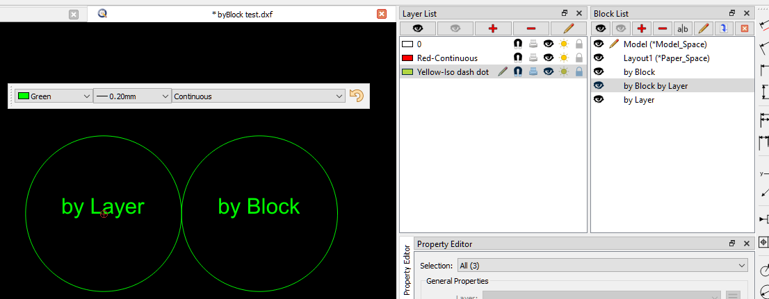

This "By Block" assignment is very frustrating to me too. My research brings me to the conclusion that the "by Block" assignment in QCAD fails or there is a different approach behind that what is unfortunately nowhere explained ...
What I found describing the "by Block" assignment in big CAD packets is in short:
"By Block" is meant to define attributes "on the fly" during inserting a block. With other words - no color, line weight or line typ is assigned to those chosen entities in a block. During inserting you have to chose those attributes which will then be adapted by "by Block" entities. I assume that part of this misconception is that we know how a layer assignment works with a clear definition of all attributes ... well, "By Block" has no immediate attribute assignment in the first place!
This said - there are a bunch of examples out there which will explain how it work. Nice - the only problem is it isn't working that way in QCAD. Honestly - I don't know why! As I already mentioned - It could be a bug or a different approach.
My last example which fails in QCAD too is very simple. Block of two circle, drawn on Layer 0, left circle assigned "By Layer", right circle assigned "By Block". Inserting into Model_Space affects both circle equally. Active Layer has no effect (left circle should be yellow / dash dot). That is not how it is described on many pages in the www for a "By Block" assignment ...
If I change Application Preferences to "Layer 0 behaves like regular Layer (QCAD)" then I get a clear result - works as expected ...
... but I lost the functionality of using layer 0.
Probably I missed something important? In that case - please enlighten me!
byBlock test.dxf
(105.19 KiB) Downloaded 7347 times
Re: Blocks, which layer to use?
Posted: Tue Feb 15, 2022 9:07 am
Tue Feb 15, 2022 8:58 am
Put the block contents on a different layer, not layer "0" and you're good to go. The application preference then does not matter at all. I think using layer "0" for block contents is a historical approach to get a similar effect as with the "By Block" attribute. You have to choose between using layer 0 or using the By Block approach for your block contents.
