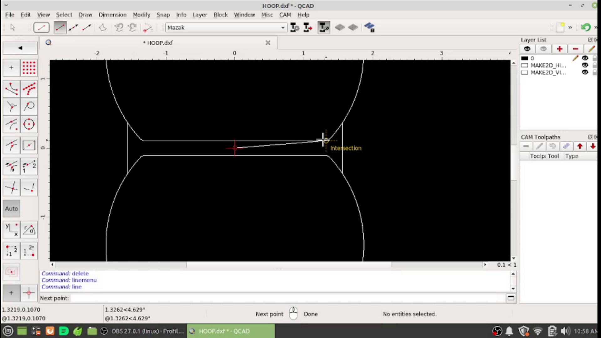

We would like to make a post that will output distance and degrees, vs traditional X-Y coordinates. I note that in the bottom window, this information is shown. Currently we are programming a lathe with live tooling using this display, it would be easier If I could write some post to do it for me. Attached pics. The dimensions I refer to is directly above the OBS box in the tray.

- Qcad_degrees_2.png (451.99 KiB) Viewed 10905 times
- Qcad_degrees_1.png (464.01 KiB) Viewed 10905 times

n_spect_r,
QCAD/CAM export can indeed be fully customized.
As example it can export in DXF, HP-GL or HTML (structure) ... Aside several G-code dialects.
I understand a relative polar notation for G0 and G1.
What with I&J for G2/3 instructions?
What with motions in Z?
You could register two extra variables for pLength and pAngle.
The name RADIUS (arcRadius) is bespoken.
Then I would source the polar notation from this.currentEntity in the writeEntity based function.
Once these values are set it is a question of formatting the outputs of:
- rapid moves
linear moves
circular moves
tool compensations
https://www.qcad.org/rsforum/viewtopic. ... 429#p28790
