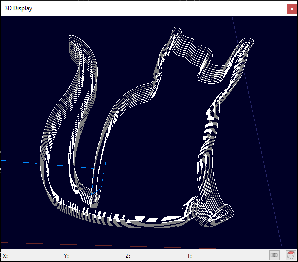

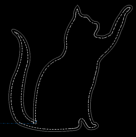

I found another problem with g-code generation. Curves are imported from svg file and converted to polylines.
When I try to generate g-code from the 'cat' path I obtain strange effect (see picture below). Any idea?
My OS: win10, QCAD/CAM 3.27.1. Postprocessor: grbl offset mm.

Unfortunately, the tool offset cannot be correctly computed in this case. This is often the case with polylines with very small segments or arcs with large radii or arcs that are almost tangentially connected, etc. where offsetting the contour fails.
In such cases, I would recommend using the offset tool (Modify > Offset) to create the tool offset manually, then correct if necessary and finally create a toolpath from that corrected offset setting the Side to On.

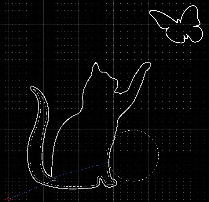

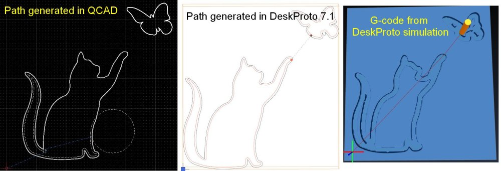

I noticed that if I enlarge the shape enough, then everything starts to work properly (g-code is correct). Regardless the arc problem, in my opinion the main problem lies in QCAD g-code generator. I did the same in DeskProto 7.1 (for dxf saved in QCAD) and everything is ok (see pictures below). In my opinion it is a bug that should be corrected.

What I don't understand is that your screengrab <cat_draw.jpg> seems to have a double contour line.

Comparing a result using different programs means you have to use the same parameter in both programs. I assume that isn't the case in your comparison. It looks to me that DeskProto 7.1 uses a different tolerance for an offset as QCADCAM does.
This said - I used your Cat shape unchanged(!) and played with the Offset settings for "Tolerance for clipping" in QCADCAM. A value of 0.0001 brought me a result where I'm not anymore able to tell a difference between QCADCAM and DeskProto 7.1.
Please test it by yourself and tell us what do you think.
