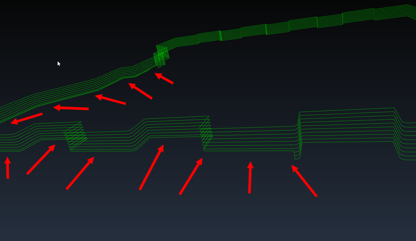

I have encountered the following problem: when generating the path for my profile (see files), the lowest part of the path is lost. It looks like a very long tab but I did not declare it in that way. Is it my mistake or problem with the CAM module?
Konrad
Konrad

Re: Error in generating gcode?
I can confirm.
Can you change the length of the tab at the bottom from 4 to 3.5 and try again?

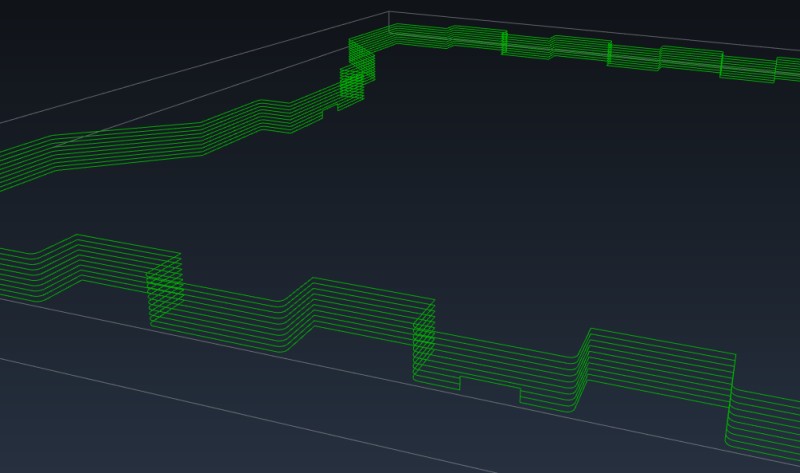

I have changed the tab length as you suggested. Unfortunately, it had no effect (see picture)
Konrad
I cannot reproduce that (with tab length 3.5) Could you attach your DXF and G-Code again?
Also, please indicate your QCAD/CAM version and operating system (see forum rules above).

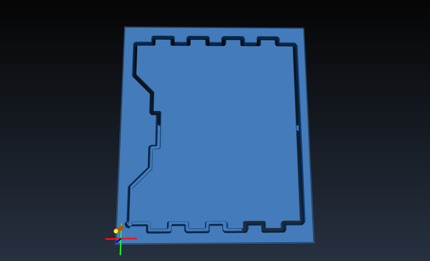

Fixed. I changed the length from 4 to 3mm and it works
Any idea what might have been the cause?
If you are using the latest release of QCAD/CAM and encountered the same issue then I think not.
The why eludes me.
In the case of K0nrad:
The cam entity was long enough so that the TAB is cleared before it ends.
Why the TAB down is missed and continues for the path that follow until the next TAB down is a mystery.
TAB's can perfectly cross several distinct cam entities.
Now from the looks of it in Test3.jpg, it seems that the TAB starts at the connection point between the arc and the line segment.
As if the cam entity was chopped into a line segment and a null-length line segment what could matter.
But then I don't get why a 1mm reduction would generate Test4.jpg there the line itself is 9.8mm long.
With 4mm and a mill of 1mm it still should be 2.4mm straight, up, 5mm straight, down, 2.4mm straight.
2.4 or 2.9mm at either side should not matter.

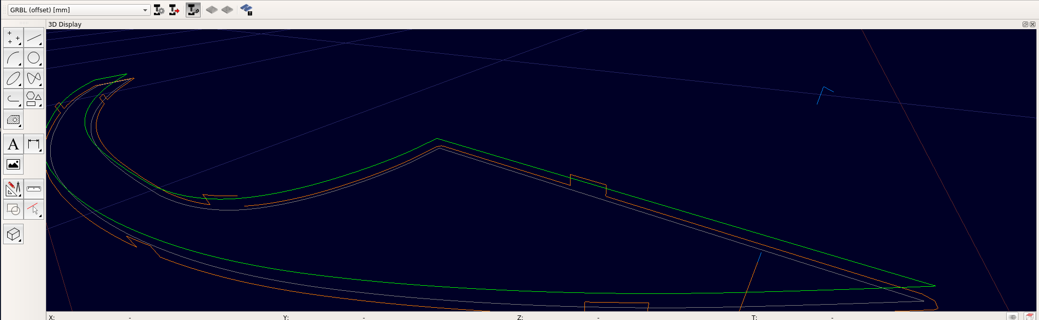

.. I am wondering if the behaviour described in this forum topic could be notified as a bug? I am encountering several occurencies of this issue in my work with QCAD. Last time it happened today:
here's a correctly planned tab: and here's a tab on the same piece where the plunge operation to finish off the tab is not planned, hence the z axis stays at its shallowest position until another tab is met
Here is the dxf and the corresponding gcde.
Already using dashed lines for the toolpaths in the 3D view bothers me.
As if the paths are interrupted.
Not sure, have you tried to set a shorter TAB length?
Remind that a 4mm long TAB with a 6mm cutter requires the tool to go up 5mm before the TAB center and the same for plunging back.
I would then place my TAB's at least 5,5mm away from a corner.
For some reason yours are placed related to lines on a layer called 'text'.
As above:
The path related to the CAM entity is split in 3 parts, the middle part is raised ... But what happens when the first or third part is nothing?
Or when the TAB spans more than one CAM entity? It typically fails at arcs then.
In most cases it goes well. In most cases the math is sound.
But I think that not all limit situations are handled in full.
Shorter TAB's or rearranging may fix that.
A CAM I tend to use ramps up and down for a TAB, it doesn't go straight up and plunges back.
Far better for your cutters and the motion is practically continuously, the FEED doesn't drop to zero.
As far as I know QCAD/CAM does not mix motions in Z with those in XY.
Your design seems to fit like a puzzle, the top right part needs to be mirrored ... Flipped over.
Have you accounted for that inner corners will have a radius of 3mm?
A round cutter can't cut sharp inner corners.
6mm for a tray sounds plenty.

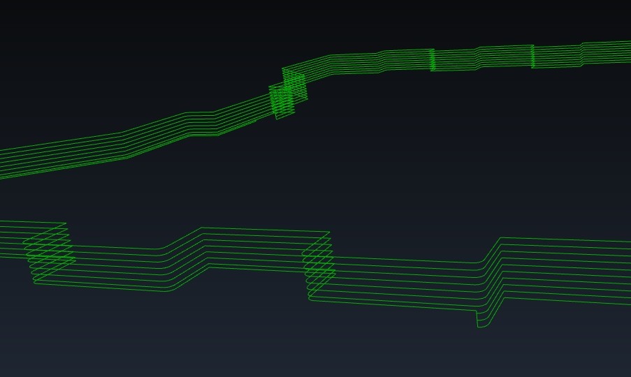

... I am plagued by this issue and I cannot check manually or with camotics or other tools that all tabs are completed correctly.
here's another occurrence where the ab is not complete and the router bit will remain at the tab's shallow depth until the next tab is met.
how can I file a bug report to have it checked upon and hopefully fixed ?
Conceptually it doesn't seem to me to be too difficult to verify that all tabs are complete with "up to shallow depth" and "down to full cut depth" commands .... What I am often getting is that the second phase of the tab is omitted!
