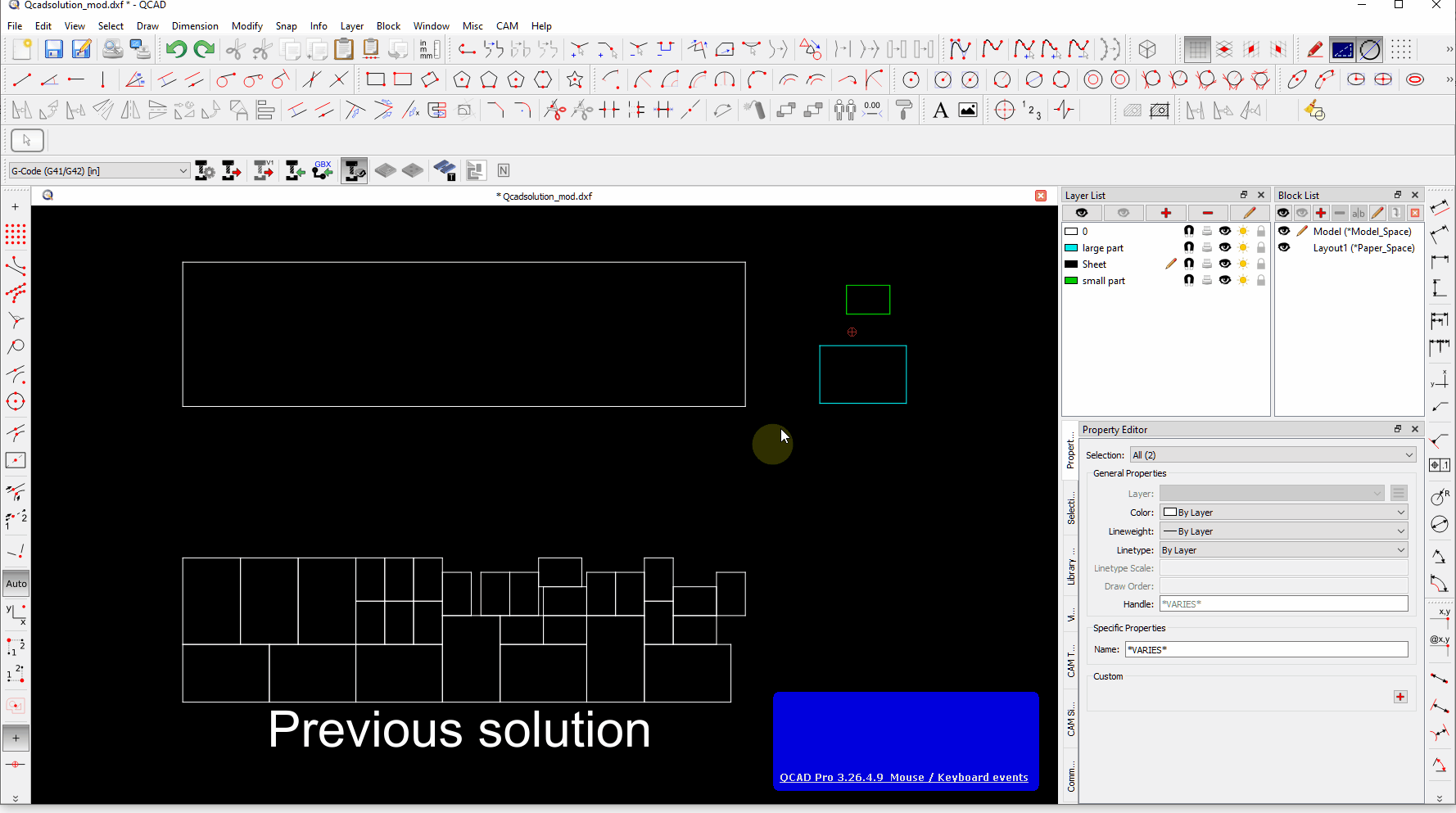

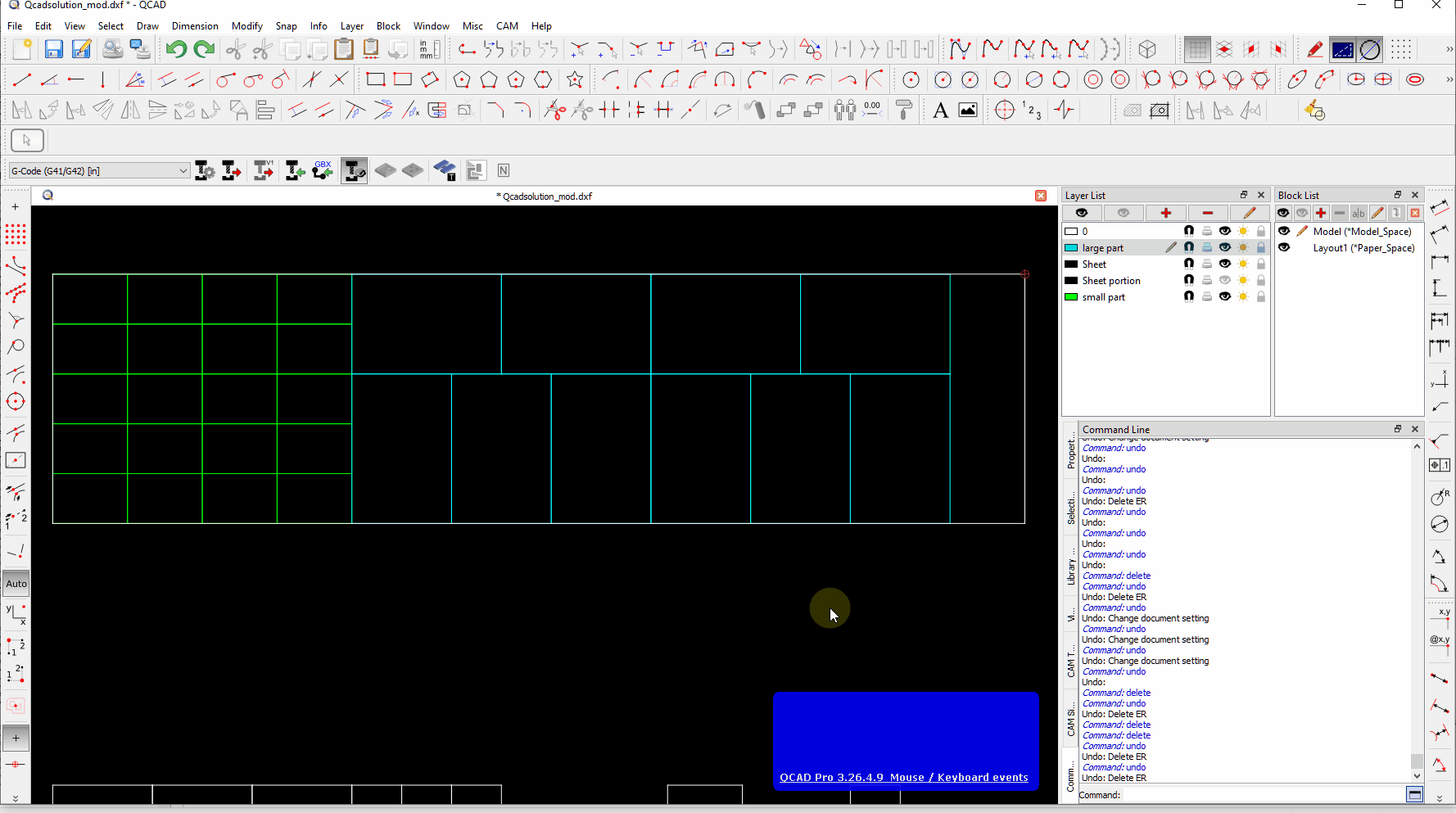

Re: Common line Removal, hull vs align nesting
Post by Husky » Fri Oct 29, 2021 8:47 am
chrispedersen wrote:
Thu Oct 28, 2021 9:41 pm
Qcadsolution.dxfAnd here is the QCadSolution.
Distance between parts set to zero.
Here is the bitter pill: A CAD nesting function is fascinating but only a mathematically solution. QCAD has no idea what you will do next with the result and how to optimize it for your further processing goals. This said - with all nesting option in QCAD you can make your life easier if you force the nesting tool in the right direction.
Your example files are inconsistent. Nevertheless my example will show the process to meet your goals: No common lines, less laser time, less maintenance.
We know that the tool "Detect Duplicates" can't find reliable partial duplicates. To avoid that we can minimize the outcome of partial duplicates with a smart part arrangement. In my example I nested by size to have most of the expected duplicates as a same length duplicate.
Now, running the removal you suggested would remove a good number of the common lines - maybe half, but not all.
Now with this arrangement we can use common sense where to look for duplicates. No need for endless looking behind the curtains ...
There are only two lines suspicious where partial duplicates could be exist and the rest will be find by "Detect Duplicates". You agree?
Ok, let's do it! If I now run the "Detect Duplicates" tool I'll find 56 duplicates - I delete them. The rest is hidden in only two lines - I clean it manually.
How much work (Time) is needed to do it this way? Nesting took me around 1:50 min. Cleaning around 50 seconds = 2:40 min. I'm faster when I don't have to document it .... :lol:
