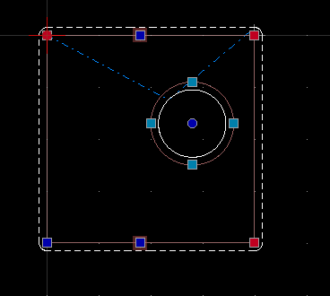

In Cam-Configuration-Menu (KK) there you can set a Home Position. For my understanding this seted Home Position is the new origin for the workpiece and generated g-code. But it isnt. Attachment 1.png shows the Path in blue which started from Home Position. workpiece lower left corner absolut 0,0.

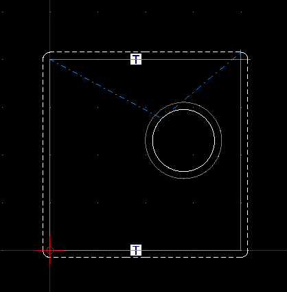

But what I need:
When moving the whole drawing (upper left corner to absolute 0,0;) then obviousley the generated g-code is as i need to have it. See attachment 2.png.
My question: Is there a way to set the origin of the workpiece for Cam output?
But what I need:
