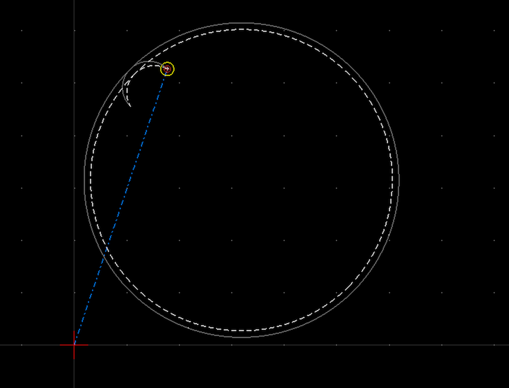

I am trying to mill out a circle 60mm where first a hole is made with a drill 2.5 mm This hole wil come in the middle of the circle ) and then the milling cutter 2.5 mm has to mill out the circle through this hole.
I cannot get the milling cutter to start through the drilled hole.
The milling cutter now starts 1.25 mm on the inside of the circle instead of the middle of the circle..
thanks in advance,
greetings Danny

Re: Milling trough a first drilled hole
Typically, the drill hole would be placed at the starting point of the lead-in for the profile toolpath after the profile toolpath has been created. Please elaborate why this is not desirable in your case. Can you attach a screenshot or a DXF file also? Thanks.
How about something like this? The drilling happens at the start of the lead in, the drill toolpath is based on a point entity constructed there.
First have a look at the new outer contour.
Where the quarter circles where typical 90 degrees they are now about 95 degrees or nearly 100 degrees.
You probably have trimmed them to the larger straight edges disregarding the short edges at those corners.
At the left high quarter circle the 2 slots are disregarded.
These 2.5mm wide slots can not be cut by the newly added profile with a 6mm cutter.
And hardly by the 2.5mm toolpath in the former art because a round cutter can not cut a sharp inside corner.
The minimal interior rounding radii are half the cutter size.
QCAD will not automatically use the pre-drilled holes as entry positions.
In Andrews example the hole to drill is placed at the start of the Lead-In.
That is what I meant by "Adapt drill position".

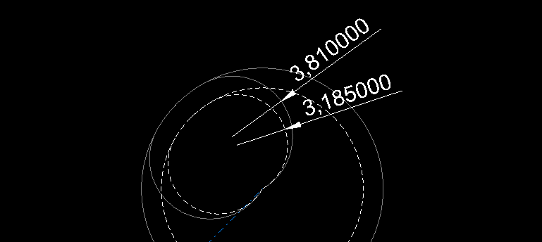

The only way I see that a Lead-in path can start at the center of the hole and end cutting tangentially at the outer edge is using a hole size related Lead-in that is a semi circle.
Under QCAD/CAM and for a hole of 15.24mm diameter that would be something as a semi circular Lead-in with R=3.81 (=25%
But for a hole of 6.604mm that would fail
... Simply because R=1.651mm and for some reason the entry radius must be larger than the tool (>2.5mm).
Below you can see that it is perfectly feasible and that the radius of the entry path is not 1.651, in green with R=1.026 it is even smaller.

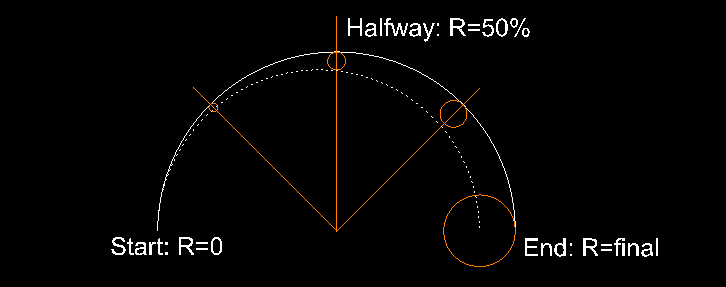

For me this is a misconception
There is something wrong with calculated offset paths ...
Seemingly the circular Lead-in is defined as the arc from center mill to the outer edge of the mill (In red).
As if the cutter has no size to start with and ends with a certain radius.
As if the cutter size is gradually compensated from zero to R=2.5mm.
Mimicking G41/42 but a (linear) cutter compensation can never be done in a circular motion.
The motion required going trough the virtual centers is not a simple arc and certainly not supported by all motion controllers that I know of.

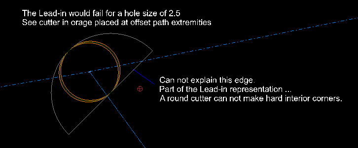

For a eighth circle I call it 'donkey ears' and you may discover that it won't be fixed.
You fooled the profile generation with a cutter = 2.499 and Lead-in Radius = 2.500
But that won't do the trick ....
And it is not the whole story because we are missing the cutter path starting at the Lead-in begin and something similar for the Lead-out.
The standard assumptions and Math for the offset are failing here.
The offset path should be a dot, simply plunge and back up with no motions in XY and disregarding a Lead-in/out or overcut.
A hole that is pre-drilled by a 2,5mm drill ... Does that require milling by a 2,5mm mill?
As said, the QCAD/CAM Lead-in radius must be tweaked according the hole size.
There is no one shoe that fits all.
Applicable for hole sizes of over twice the Lead-in radius although it is feasible for 100,00..01%
At some point you may consider drawing the offset path and Lead-in (dotted) yourself as per example dxf and mill on path ...

Partial solution:
