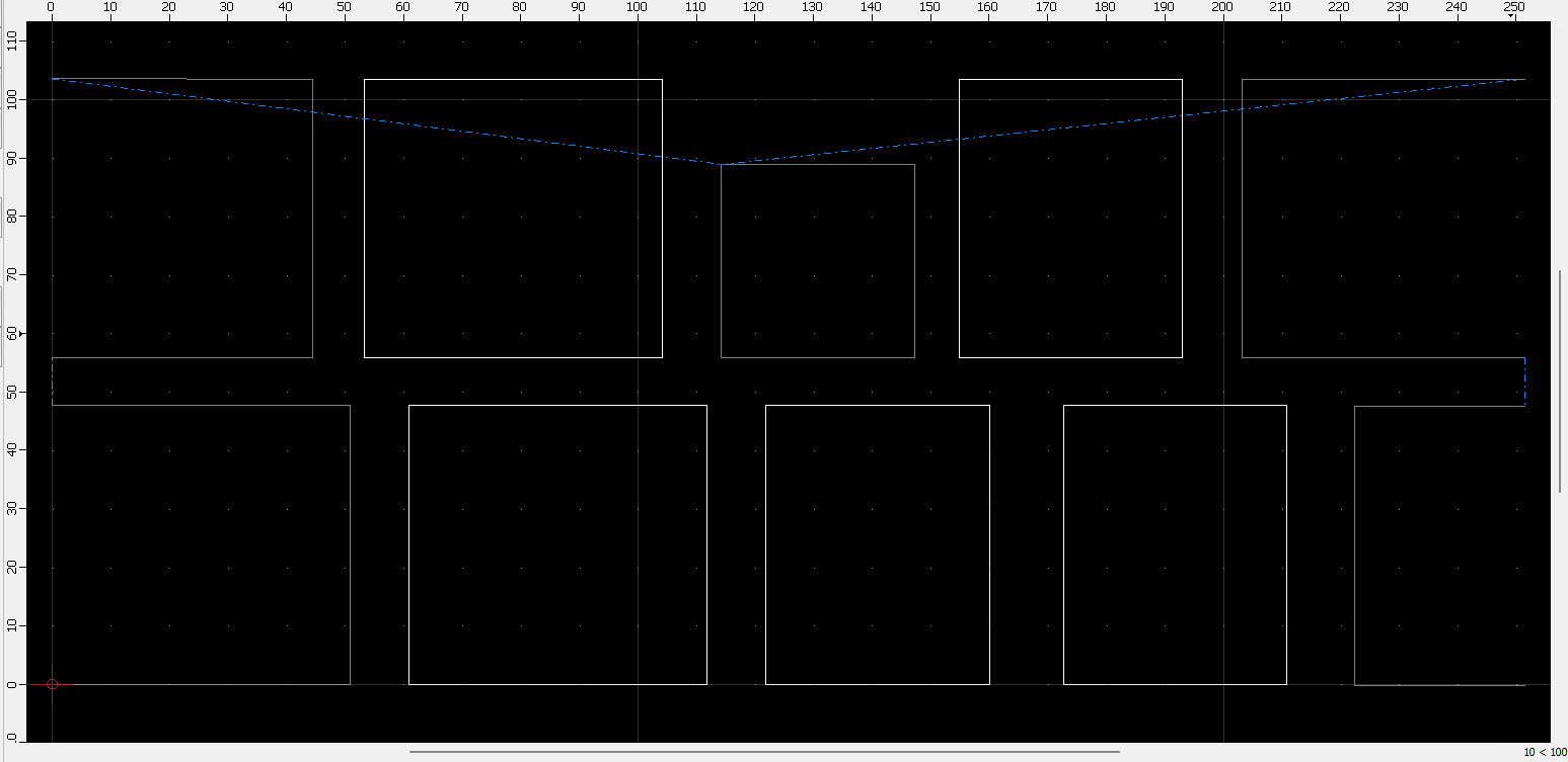

I created a drawing of boxes; each box is a block. I truncated some of the boxes to fit the work envelope on my CNC machine. When I created the toolpath only the truncated boxes and a box that was edited into a smaller box were part of the tool path, none of the blocks were included. I tried exploding one block to see it that made a difference – it didn’t.
I’m trying to determine why the blocks are skipped.

You'd have to explode the blocks and then re-create the toolpath. Blocks cannot be used as basis for toolpaths as they can contain any combination of entities that might or might not be suitable for a toolpath.
Note also that one of the blocks has been inserted twice in the same spot.

Thank you for the information. Exploding the blocks worked. I had to delete the previous toolpath and generate a new one.

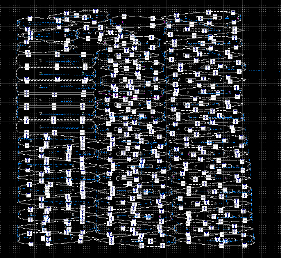

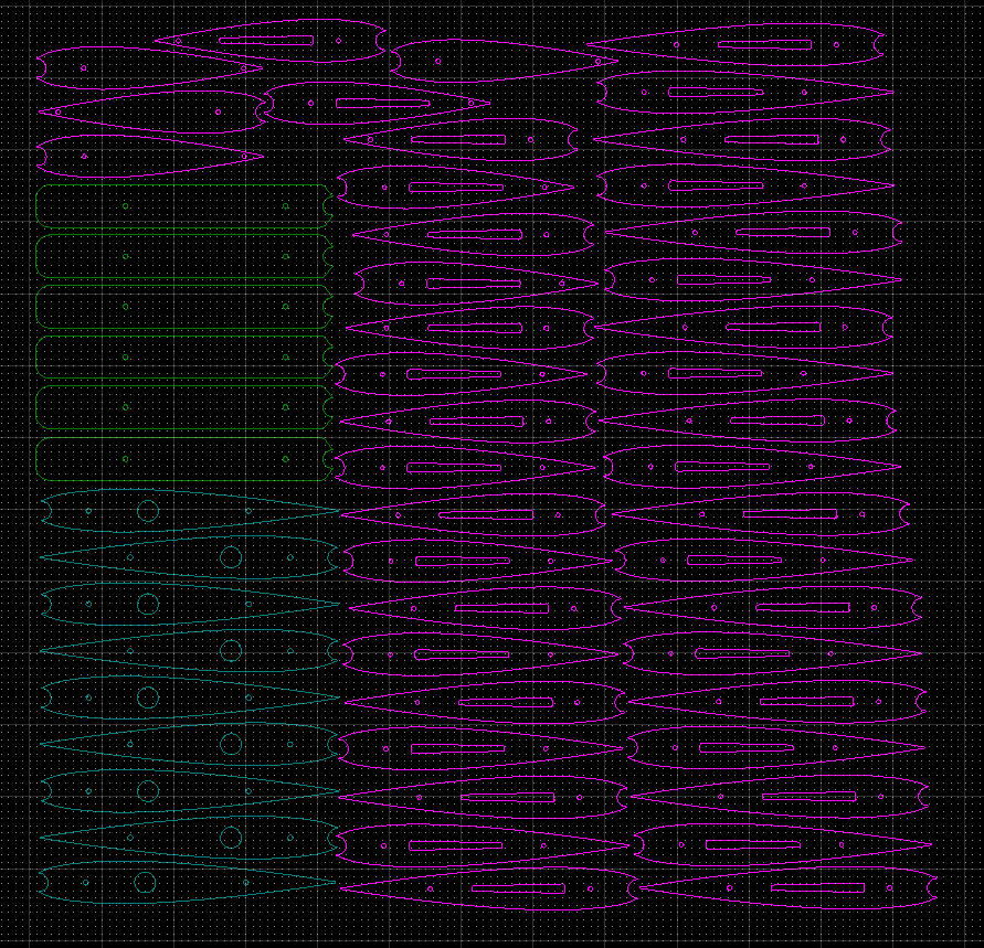

I'd be grateful if you could share how you would handle a project like mine? See the CAD below: it includes 58 objects to be CNC cut. Each object includes 5 lines, 2 circles, 2 splines and 5 arcs. It is quite diffuclt to select an object when the others are packed tighlty as in my file. Would you go for one layer per object? or else?
Below is the CAM which looks fit for my purpose, however I wouldn't refrain from tweaking some object positions. Thank you for your ideas and suggestions

Re: [solved] - Toolpath Skips Block
I see your problem.
Reading another topic on groups it seems that ACAD has something like that.
It does not entirely mimic the Block functionality and I read about issues with that.
In my wish list I added an entry for some similar functionality.
Adding a parameter or a custom tag/property so that we can select items of a group together.
I think it will not be that hard to add a selection change listener and then filter all drawing entities based on the selected tags.
But it is way down in my ToDo list.
They are all different shapes I presume or probably pairs.
One could create a layer for each ... With a sub-layer L and R for example.
