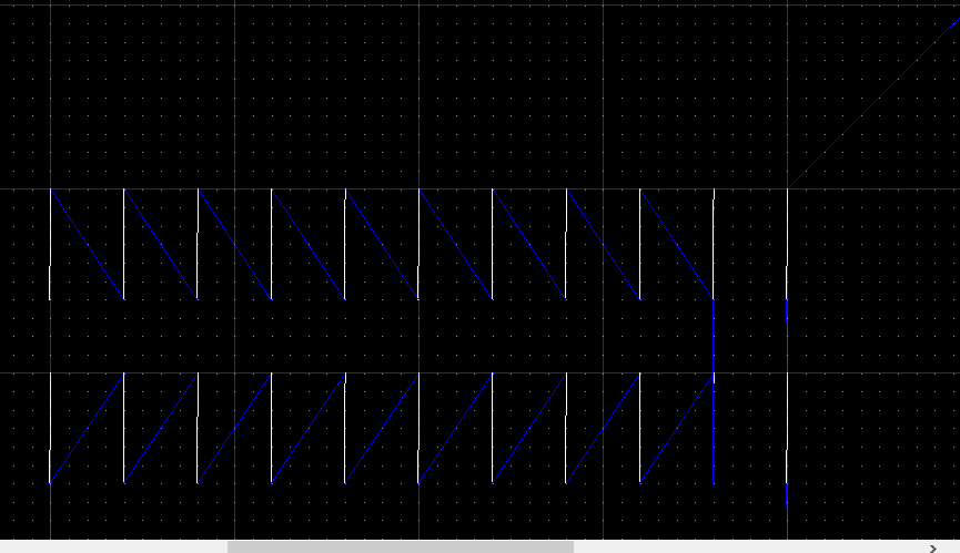

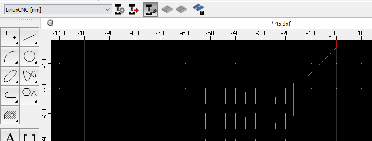

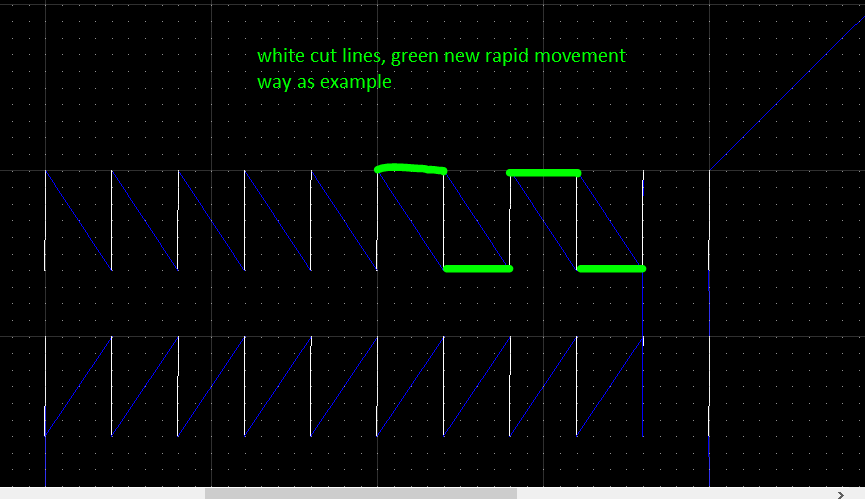

Hello QCAD/CAM team, I'm new at this forum.
I created DXF files with only lines to cut, then I export file using LinuxCNC postprocesor.
I would like to reduce cut time, I mean reduce rapid movement lenth between points.
Question 1
I use LinuxCNC Postprocesor to create path. It works fine.
I see that QCAD use always start point of the line as first point to cut.
Is possible to change that default settings to use end point of the line
as first point to cut?
Or use nearest line point (start or end) to set as start cut point?
I ask because this idea can make shorter total cutting time.
Diagonal is longer than straight line :)
See my screenshots. In green new view
Thank you!

Re: CAM Export questions
Post by Husky » Wed May 31, 2023 10:47 pm
ha4n wrote:
Wed May 31, 2023 2:24 pm
Correct and that is what you can use for a better path strategy.
No but you can reverse the orientation (start becomes end and end becomes start) of the line with Menu / Modify / Reverse (RV).
Your example modified to an alternating direction of those lines looks like this (red = start, blue = end point)
A path can then be created with a more optimized outcome ...

The gain is here much more pronounced then with optimizing Start/End. :P
I think that most machinist and businesses are interested in the estimated cutting time and not in the traveled distance.
This is even harder to estimate because we need to account for acceleration and deceleration time. e_geek
@ ha4n: May I remark that the plunging FEED is 10 times the actual cutting FEED. :shock:
In the end this will kill your cutter as it is slamming in full cut on your workpiece at 600mm/min.
Usually it is reversed: cutting FEED 600, plunging gently at FEED 60. :wink:
This kind of aggressive entry strategy may be required for surface hardened materials ... For the first handful of microns. :wink:
In perspective, with infinite accelerations (... what is not of this world :lol: )
Cutting: 1086.58mm at FEED 60 >>> 18min 6.58sec
Traversing: 1446.38mm at FEED 1414 >>> Less then 1.5min (Assuming all at 45° with Fmax1000 in X & Y)
Traversing: 817.33mm at Fmax1000 >> Less then 1min (Assuming Fmax1000 in X or in Y)
Retracting to Z10: 2238.80mm assuming Fmax1000 >>> About 2.2min
Retracting to Z3: 887.80mm assuming Fmax1000 >>> Less then 1min
Plunging: Somewhat slower depending the pierce FEED for the last 2.4mm.
It takes more time to optimize G0 motions or write about it compared to the gain in fabrication time. :lol:
Still, optimizing is good practice when you need hundreds or more pieces.
Remark that I used moderate traversing FEEDs, my CNC engraver works fine with Fmax5000 reaching top FEEDs up to F7000.

That isn't that simple! I agree to disagree! How will mathematic decide that the nearest point is the correct / logical and common sense strategy? I can imaging a lot of scenarios where your approach would destroy the workpiece what means even mathematics can make mistakes ... :shock:
Well, it is actually NOT a mistake but it still goes south and the workpiece ends up in a garbage can ... :lol: :lol: :lol:
Hi Husky, Maybe I not explained well. In my project I'm focused to get the shortest total patch because my router will engrave multiple times the same path (only lines). My goal is to reduce rapid movement beacuse cuting path is constant. In this case we see that QCAD automated generated total path for project is/ can be 2 x times longer than updated with "reverse" change. This update "reverse" path I need do it manually with my experience. I try few times to "reverse" lines but not always help it to get shorter rapid movement way. And in this point I think that mathematic can do it better than me. Sometimes next line end is closer than next line start. This equation can be done faster by math (algorythm) then by me trying to find it few times :)
I also understand that main 'time consumig" is cutting path, that is true, but why not reduce rapid movement? :)
Anyway many thanks for help and I will back with new project to ask how to make it faster :)
