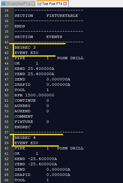

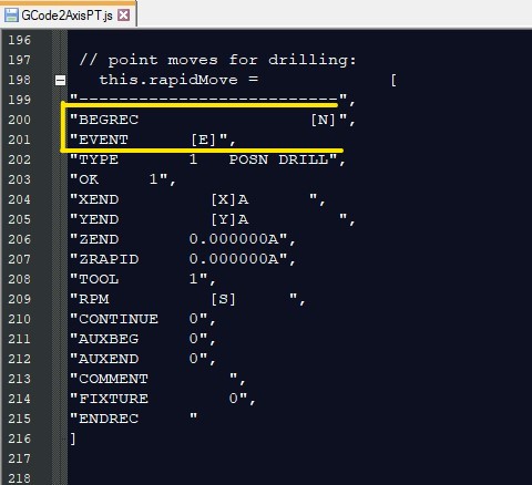

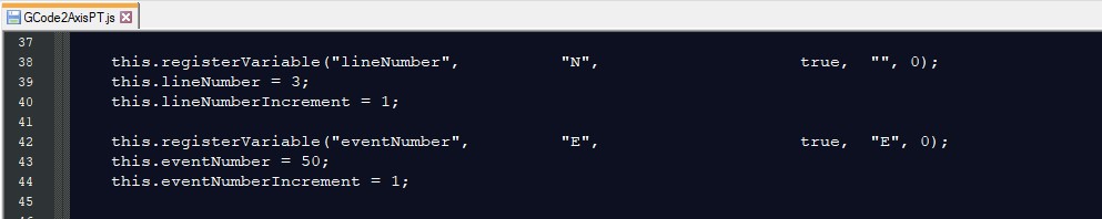

I am in the need of two variables that increment by 1, each time they are called up.
I am using the 'N' linenumber as as one of the variables.
I made another variable in the JS file, and called it eventnumber.
It does show in the post, but does not increment.
I have some screenshots attached for reference.
Thank you.

You'd have to detect when [E] gets written and increment accordingly:
GCode2AxisPT.prototype.writeBlockFromString = function(blockStrings) {
    if (isNull(blockStrings)) {
        return;
    if (isString(blockStrings)) {
        blockStrings = [ blockStrings ];
    // detect usage of [E]
    var incE = false;
    for (var i=0; i<blockStrings.length; i++) {
        // blockString
        // e.g. "[N] G01 [X] [Y]"
        var blockString = blockStrings[i];
        if (blockString.contains("[E]")) {
            // a block string contains variable [E], increment after writing
            incE = true;
    // write block strings:
    CamExporterV2.prototype.writeBlockFromString.call(this, blockStrings);
    if (incE) {
        this.eventNumber+=this.eventNumberIncrement;
This is overly complicated and we will add a function to detect variable usage more easily. This will work with QCAD/CAM >= 3.25.2.11:
GCode2AxisPT.prototype.variableUsed = function(id, value) {
    if (id==="E") {

Wow Andrew!
I have no idea how you did that. it works perfect, thanks!
I could have never figured that out.
