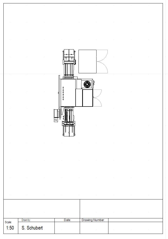

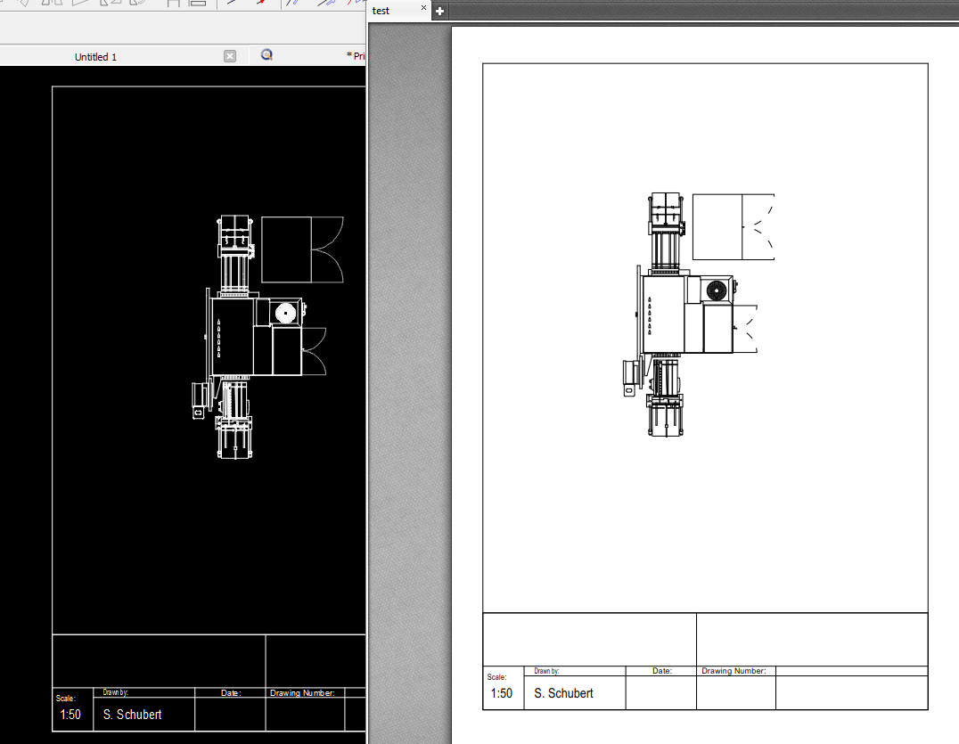

Here is a sample:
Export with Microsoft PDF writer via print dialogue (same result as a real printout)
PrintProblem_QCAD.pdf
(177.7 KiB) Downloaded 891 times
Screenshot how it looks like in CAD
CAD Drawing
PrintProblem_QCAD.dxf
(267.22 KiB) Downloaded 853 times

Sometimes I have some missing lines, dots, text, etc. in a printout. I have the same missing bits and pieces when I do a PDF export by using the print dialogue and the Microsoft PDF writer.
What exactly is missing? If I compare the QCAD drawing with the QCAD pdf result I can't really see what is wrong.

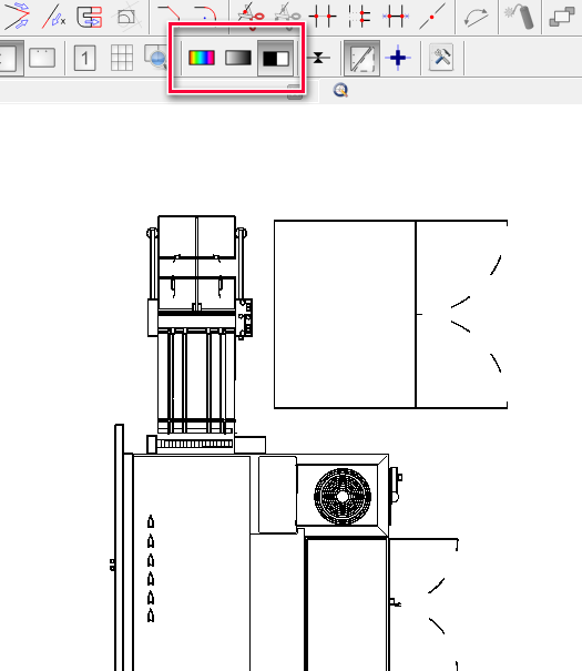

Howsoever: What is your print color mode? Full Color Mode or Black / White Mode?

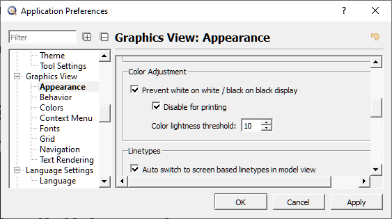

We don't have all info's - so I have to ask my crystal ball :D
Here my wild guess. :shock:
The drawing has layers with black and white attributes - I don't know why ...
Application Preferences / Appearance is set to Color Adjustment: "Prevent white on white / black on black display" - works nice in Model_Space.
Additional the Appearance is set to: "Disable for printing"
The user prints in "Full Color Mode" and the entities on the white layer disappear. Why? You can't see a white on white entity ... :(

I think (still not 100% sure) your wild guess is right. However, difficult to understand the secrets behind.
I was never paying attention to the setting prevent white on white and black on black so this is activated and unfortunately I was creating some bits and pieces in white on white but never realised it as I got them displayed in black....

White is fine and the preferred color. White is shown as either white or black, depending on the background. This is very important since you very likely want to see your lines in model space (on a dark background) and you very likely also want to see them in a PDF or on paper (on a white background).
Make sure "prevent white on white and black on black" is always on. Unless you have filled areas which need to 'print' as white (i.e. not print), you should always keep the "prevent white on white and black on black" on.

Are you saying that QCAD should print white lines as white (i.e. not print them)? Or that black lines should be invisible on the screen? If so, you can of course disable the "prevent white on white and black on black" preference.
