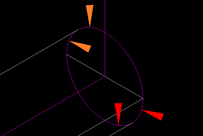

Greetings!
I installed the latest edition (3.32.3.0 (3.32.3)) (Windows 11pro) and now the Breakout line segment is not working properly. In the below example I am trying to draw a cutaway of a part using isometric projections. In the example I am trying to trim the purple circles, but they ether don't trim at all, trim a section I didn't click, or removes the circle entirely. I have literally drawn hundreds of parts using this method using previous editions and now its not working. Any ideas on what is going on?
- Breakout Line Segment Example.dxf
- (98.82 KiB) Downloaded 125 times

I can replicate the weird functionality with trimming parts of the magenta Ellipse entities at the right.
Probably related to updates to the ellipse resources since QCAD 3.32.0.
Some were moved to the Pro or proprietary realm but it can be some QSharedPointer issues too.
Unable to verify what goes wrong because a least some parts are proprietary code now.
Then I doubt that the isometric projection of a circle resembles an ellipse.
The projection of the circle axes are not orthogonal, major and minor axes of ellipses are always orthogonal.
Tangent lines to ellipses are at least a mathematical problem.
Presumed is that the internal fixed absolute tolerances up to 1e-4 in handling these are coarse enough.
Even for these small shapes.
But a key mathematical resource may fail ... Refer to: REllipse.getVectorTo(p) exceptions
Several other resources rely on that.
And that may be an issue for any intersection, normal or tangent with an ellipse or for points on an ellipse.
Another issue I noticed long time is that full Ellipse entities have:
For angles a 360 degree value may get replaced with zero or not depending the used code, a zero sweep may be regarded as full.
Something similar exists for Arc entities: Odd circle ... Full circular arc
The solution is then straightforward.
Divide (DI) each full Ellipse entity up in 2 Ellipse-arc entities.
It may be required that intersecting lines are really crossing, elongate them a bit.
If you attempt DI at the intersections with the blue line under QCAD 3.32.3 it is cut up at the minor points.
Proving how wrong it can be.
getVectorTo(p) where p is one of the intersection with the blue line returned a minor point as cutting position.
Another solution is to explode your Ellipse entities into bulging Polyline entities.
Visit the Application Preferences for how many segments per full ellipse.
I don't have these issues with Ellipse entities anymore since I started using the resources also presented in POC_NearestPointOnEllipse.js
The outcome is no longer based on guessing and is always as exact as possible.
The 'far-side' perpendicular points ABC for Ellipse entities is another enhancement among several others.
Seems that nobody is interested in this but me.
But all these things are implemented under my licensed version QCAD 3.27.6.
I had/have more general GUI specific issues with all later versions up to the most recent.

Update:
Probably boils down to Ellipse - Line intersections failing in the latest releases.
Filed a bug report with an example file: FS#2685
Ellipse - Circle intersections work well for example.
It is not my task to examine all possible combinations.
But other methods relying on the same resource like DI may fail too.
Two methods to work around were presented.
The issue with D2 seems to be limited to the Ellipse - Line case.

Update:
Traced back to RShape.getIntersectionPointsLE(line1, ellipse2, limited); (Where suffix 1-2 are swapped)
Line 771-776 verifies if the line is (almost) a tangent. (current reference)
... Because the blue line is not a tangent at all, it clearly crosses the ellipse twice.
Mimicking the math in JS the discriminant of the quadratic equation is 0.00021697730054059171
Positive, what means that there are 2 real roots ... 2 intersections with the ellipse ... Thus not a tangent.
But this is considered to be ZERO in line 1200-1209 (current reference)
What would mean that there is but one intersection or one single point of contact if that was true ... A tangent.
Such faults are widespread ... A discriminant equal to zero in the literature means exactly or almost zero.
Here it is compared with zero, given a tolerance of 0.001 units, and +0.0002.. matches within tolerance.
Floating Point math has it limitations and we should indeed allow some minor tolerance.
But in no way we can use a certain deviation from zero to define 'almost' a tangent.
And as said: "Tangent lines to ellipses are at least a mathematical problem." (Because of several other incorrect shortcuts)
Still, in the region between +0.001 to -0.001 is not appropriate.
I have to point out that we don't have a complete quadratic equation.
Parameter B is almost zero (-2.824192708992169e-16) what leaves A²x+0x+C=0.
The reason is that the Y-intercept in double c is almost zero: -3.913536161803677e-15 (Note: y-intersept is a typo)
No line that (almost) crosses an ellipse center can be a tangent.
Or the ellipse has to be so small that it rather looks like a point in any zoom state.
If you test that for hundreds of lines crossing the center ...
... You might discover that for the intersections inside the ellipse evolute a correct intersection point is returned.
If any, typically near both minor points.
The slope of the normalized lines becomes large with its limit at infinity.
A solution would be:
I referenced this follow up in the bug report.
- ellipse2.getTangentPoint(line1); returns the ellipse center.
Which is a valid RVector and is therefore wrongly considered the only solution.
Not quite the center of the ellipse, the returned point is 3.972e-15 away from it what falls within RS.PointTolerance.

- Posts: 4920
Re: Breakout line segment glitch
Chuckk, Andrew,
Using the latest release (3.23.4), D2 still has problems with breaking out some obvious ellipse segments in your example file.
Found intersections of lines and the ellipse, and thus breaking points, are already much better.
D2 and indicating near segments with the red arrows removes the ellipse shape completely.
Undo (OO) reverts back to the original.
This is probably unrelated to intersections with an ellipse because we can snap to all 8-9 obvious intersections points for this case.
At the high side it is suspected to be a case of a tangent line but then not actually crossing, nearly but just outside the ellipse.
No snapping to an intersection occurs for the two tangent lines.
For the segments indicated with orange this can be fixed with trimming the line to the ellipse (RM).
But trimming (RM) the tangent for red results again in removing the ellipse shape completely with D2.
Evaluating this setup mathematically in terms of the backing code may shed some light when and why this happens.
To my knowledge, nearly a tangent to an ellipse but just outside is still not accounted for.
A true tangent, or nearly but crossing twice extremely close together should not be a problem.
For the latter, the code returns only one of the two positions, arbitrarily, not something in between.
