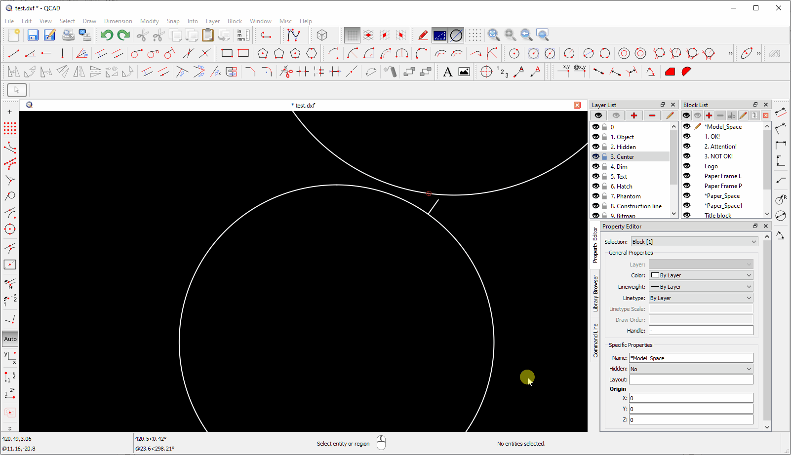

Hello guys, like what the title says how do I snap to two points or is there collision detection to push objects together without gaps in Qcad? And if not then what is the best way to go about it?
To give you a gasp on what I am trying to do. Here are the some examples but read them in order
1st example, in this screenshot now I inserted some squares at various angles and tried to line them up. For the first role that was simple but for the second. I can get them to perfectly touch one but not the other. I guess the workaround would be to resist the movement to one angle of the line in which it touch to align it up to the other.
2nd example, lets say I want to do the same thing with circles…. I have no clue what work around would be.
3rd example, between these two circles lets say I needed a line with a length of two, now mathematically a place should exist. Now, I can align it to one but I can not align unless I move it but than that would of course throw off the first point. Perhaps if it was a slight lines there would be a simple mathematical formula I could use.
I draw up designs which they resembles diagrams which also require I get it correct. Simply if I was drawing on it on a sheet of paper I could just simply cut out the shapes and push them together. It’s should logically be easy to do and is quite intuitive but I have no idea on how to actually do it.
Any ideas?

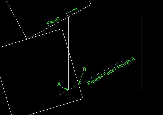

For the squares it is less simple.
Just because they have corners sticking out. :lol: :wink:
Again this requires construction lines and QCAD has several tool for that.
But here we talk about sliding a corner along a face (= line) until another corner meets another face.
I would solve this by a parallel of the face trough the other corner with Draw .. Line .. Parallel (trough Point) (LG).
Then it is a question of moving the shape from one reference to another with Modify .. Move/Copy (MV)
Select the square to move, type MV, not copy or delete original, from point A to point B.
And of course, every problem will have several unique solutions and several ways to solve them. :wink:
Rotating a square around a corner so another corner meets a face requires a construction circle around the corner trough the second corner.
Then you can rotate the shape around the corner so the the other corner is where the circle meets the face.
Hint: In that case you define the angles with the mouse cursor (not by value), that is the pointer button beside the angle field in the dialog.
