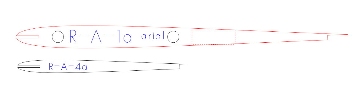

Kindly requesting your help to use QCAD to resolve this issue.
Situation:
I want to lasercut parts for a model glider, from 2mm plywood, at the fablab nearby. The fablab accepts dxf-files as input, the fablab's laser-software is then used to create gcode.
The design is created in a specialized model plane 3D cad program, devwing, and exported as a dxf-file.
With QCAD I've opened the devcad-dxf and saved the parts (two ribs) to be cut from 2mm plywood in a separate dxf-file, for the fablab to check if it is suitable for the laser-software. They check that using CorelDraw, I think version 2007 or 2017; anyways, a very much not recent version, but definitely suitable for their compatabilty-check.
I run QCAD Professional 3.32.3.0 (3.32.3) on W10 Pro.
The issue

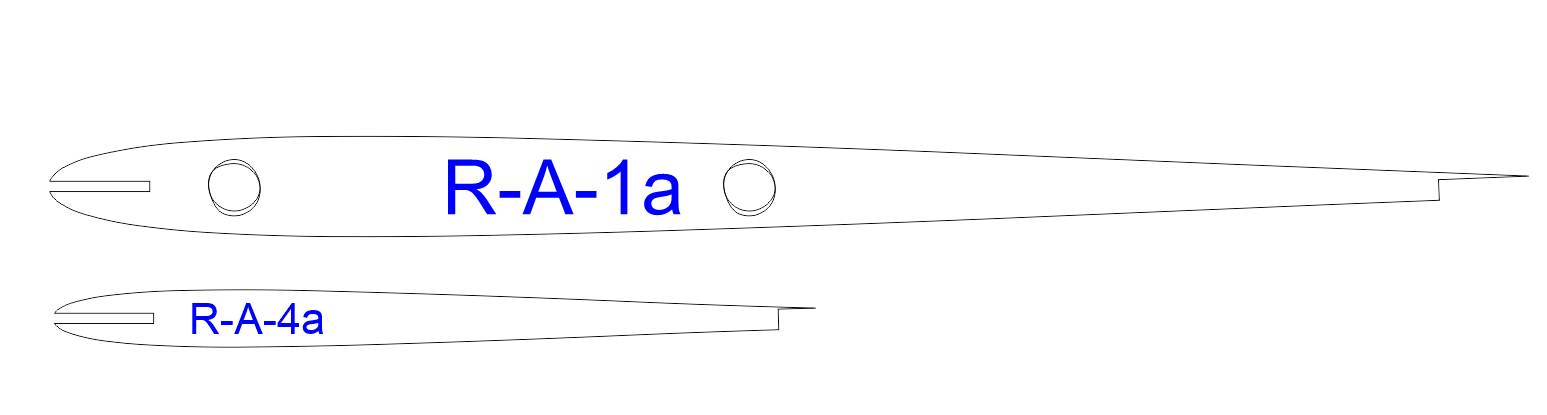

The file I supply, the attached Amokka Fin geodesie 5_1_Triplex2mm, contains two ribs, with the top one containing two round circles (that will become holes)
The fablab sees not those round circles, but sees each circle as two overlapping ellipses: see attached image What fablab sees_Amokka Finparts triplex2mm.
What I want the fablab to see, are the two round circles.
My question:
1. How can I make those ellipses in the file that I supply, visible in QCAD?

Situation:
The issue
My question:
Kind regards,
Arjan

- Posts: 5072
Re: One dxf, two cads see different things -hiw to resolve?
Hi Buntehuhn - welcome to the Qcad forum.
Your drawing was among other things edited with 3D. To be sure that everything is now 2D, I recommend first converting the drawing in Qcad to 2D.
Load the drawing and run ... "Flatten drawing to 2D": Menu ... Misc ... Modify ... Flatten Drawing to 2D.
... just to be on the safe side
Maybe this will already solve your problem - if not please feel free to ask again. Thank you.
- Posts: 5123
Hi, and welcome to the QCAD forum.
IMHO there are no Z coordinates different from zero.
Flattening a drawing that is already 2D has no further effect.
It won't solve any of your issues.
Model_Space shows 6 entities in total: 2 ribs outlines, 2 additional 'circles' and 2 text entities.
The top of 2 ribs is a Block Reference based on Block '*R20' what already includes 2 holes.
The leftmost hole has a duplicate: A Block Reference based on Block '*R21'.
The rightmost hole has also a duplicate: A Block Reference based on Block '*R22'.
When selecting entities that are superimposed try selecting with holding down the ALT key.
You should already fix Block names because starting with an asterisk is an invalid name (= Anonymous block).
You could also consider to replace the circular shapes by real circles ...
If you would be able to locate the correct center (See lower).
Eventually exploded to Polylines or exploded further into 2 Arcs by QCAD if that is required.
I would expect more holes to make the profiles even lighter.
In all 3 Blocks a circle is represented with a polyline with 2 semicircular segments.
'Arc like segments' or better 'Bulging segments' because one can convert them in both ways but never exact.
Bulging segments have end-points, Arcs have end-angles, an Arc has a center, a Polyline segment has none.
(Before anyone disagrees: QCAD explodes polylines internally for snapping to centers of Arc like segments for example)
For a perfect semicircle we expect them to have a bulge factor of 1.000...
Comes from bulge = tan(sweep/4) => tan(180/4) = 1.0
A fully circular 'Arc like segment' is not possible: tan(360/4) = tan(90) = Error (= infinite)
QCAD automatically prevents that on exploding a circle, on converting a circle to a polyline, ... , on saving and on loading.
I suspect that these polylines are not generated by QCAD:
- Would be a logical closed Polyline with 2 vertices, not as open with 3 vertices.
- The 2 vertices would be at 0 and 180 degrees.
- Both the bulge factors would be 1.000 exactly.
Why fablab displays them incorrect I can not tell and is outside the QCAD scope.
It has to do with the bulge factors and the orientation.
The third vertices typically has a bulge factor equal to the second.
So said 'circles' in Block '*R20' are drawn CW and in Block '*R21' and '*R22' they are drawn CCW.
Exploding the 'circular' polylines to Arcs reveals:
- Top Arcs in Block '*R20' have a sweep of -174.85847228
- Bottom Arcs in Block '*R20' have a sweep of -185.14143425
- Top and bottom arc of one so said circle don't have the exact same center, the radius is almost 2.5 but not exact and not equal.
- Both Arcs making up one (almost) circle don't connect tangentially.
Similar for Block '*R21' and Block '*R22' but then with positive sweeps.
The application that generated these polylines from circles did not a great job.
The same is true for the outlines of the ribs what probably were Splines at some point.
Stepping through the vertices of the top profile reveals connecting angles varying between 179.82747097 and 181.29127169 degrees.
Meaning that the transition from one Arc to the next is not smooth, your profiles have dents and kinks.
More pronounced at the front tip where small Arcs are replaced by short but straight segments.
The bottom profile then uses a small Arc at the tip: index 1 > about 185 degrees and that is a visual kink, index 16 > about 176.1 degrees.
QCAD explodes Spline to Polylines with tangentially connected Arc like segments.
Perhaps it is an idea to do all the conversion to polylines in QCAD.
Then you could avoid to explode Circles to Polylines, see: Application Preferences .. Modify .. Explode.
Remind that the stricter the exploding tolerance for Splines, the more Arc like segments are created.
The QCAD representation is perfect.
- QCAD Pro .. Misc .. Block .. Fix Block Names
The fablab examined my latest dxf-files, resulting in that I should use a single line font (appearantly Arial ain't one) and another instance of him seeing something else using coreldraw, than me using qcad.
That instance is that I see the rib/object on the bottom as a red line, he sees it as a black line (see screenshot afbeelding.png).
The according dxf-file is Amokka Fin geodesie 5_1_Triplex2mm_nodupls_lyr0_fonts_crcls_polycloses_oneblock.dxf
What configuration item in qcad could explain that, and how should I correct it?

- Posts: 5123
Your second question tends to fall within the scope of the topic title:
I have no idea why CorelDRAW would see a black line instead of a red line.
"CorelDRAW" meaning the vector graphics editor is capable of importing DXF files, its native format is CDR.
It is also the name of the Corel graphics suite including various graphics-related programs.
In essence not really intended to be a CAD application, more geared to graphical illustrations.
Per example, no well established CAD application is listed under: Comparison of vector graphics editors
Shape R-A-1a lives on layer 0 and has a custom color attribute defined.
Entities living on layer 0 would typically inherit the layer attributes with 'By Layer'.
The color would then be white but this can be corrected to avoid white on white and black on black by an application preference in QCAD.
Perhaps you could place those entities on a layer that uses red ...
An online search on terms including "coreldraw dxf import limitations" may shed some light on many of the limitation.
TTF or OTF and so on are filled outline fonts.
The character glyph's are coded as outlines and an algorithm is used to fill the area between them.
One of the benefits is that these outlines as vectors can be scaled loss-less.
A game-changer replacing the historical pixel fonts.
Should not be an issue for a graphical oriented app, fills are supported widely.
Standard.cxf is for example a QCAD native font type that uses single stroke characters.
The vector art is rendered in QCAD with the configured Lineweight ... With a round pen.
For usage one a laser CNC that could be merely the laser spot size but then scorched, not cut.
Color coding like blue for engraving may apply.
Buntehuhn
- Posts: 22
- Joined: Wed Aug 06, 2025 6:38 pm
As the fablab uses Corel Draw to precheck dxf-files before they feed into the gcode-generating-software I'm bound to pass their test.
The fablab needs all objects to live on the same layer, so both that need to be cut and those that need to be scorched.
Lines to be cut must be in red, those to be scorched must be in blue.
That's why my objects are in layer 0, with custom colors red and blue, rather than 'color by layer'.
The font must be a single line font.
I've rechecked my file again, and found it to comply to the requirements above.
My file uses indeed the single line font 'standard' that lives in qcad.
The Fablab couldn't read it, and pointed me to the cambam single line fonts. I imported those - remarkably with a ttf-extension - and used them in th enext version of my dxf and sent it to fablab to find out which one they actually do see. I'll report back here.
Fablab couldn't explain why they see one object in white
Great suggestion to google on dxf importing limitations of/for Corel Draw; I could not find a useful suggestion

In the attached file "Amokka Fin geodesie 5_1_ ... _oneblock.dxf"
- The outline of Shape R-A-1a is indeed in red
- The circles in that shape use 'By Layer', text are in blue.
- The outline of R-A-4a also uses 'By Layer' ... White corrected to Black.
- The text in that shape is in blue.
Probably fixed with setting R-A-4a shape to red ...
The same would be true for the circles in the R-A-1a shape.
I can't explain the dotted red rectangle.

No TTF can define such a thing.
The outline is coded in such a way that it looks ultra narrow, that there is nothing to fill.
In fact, it re-traces everything twice ...
... The laser would scorch everything double.
