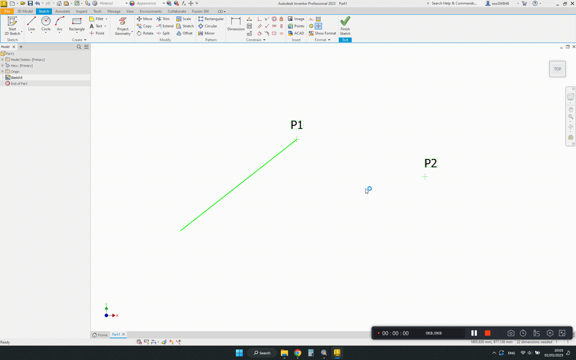

Please see attached.
I try to draw an arc tangent to a line which starts with point 1 and ends with point 2.
It can be done using circletangent2p but then I have to delete the part of circle which I don't need.
Regards
Szymon

- 20230302_195326.gif (1013.32 KiB) Viewed 53446 times
- 20230302_200353.gif (676.74 KiB) Viewed 53446 times

thanks for the demonstration. You convinced at least me that this arc tool would be nice to have.
