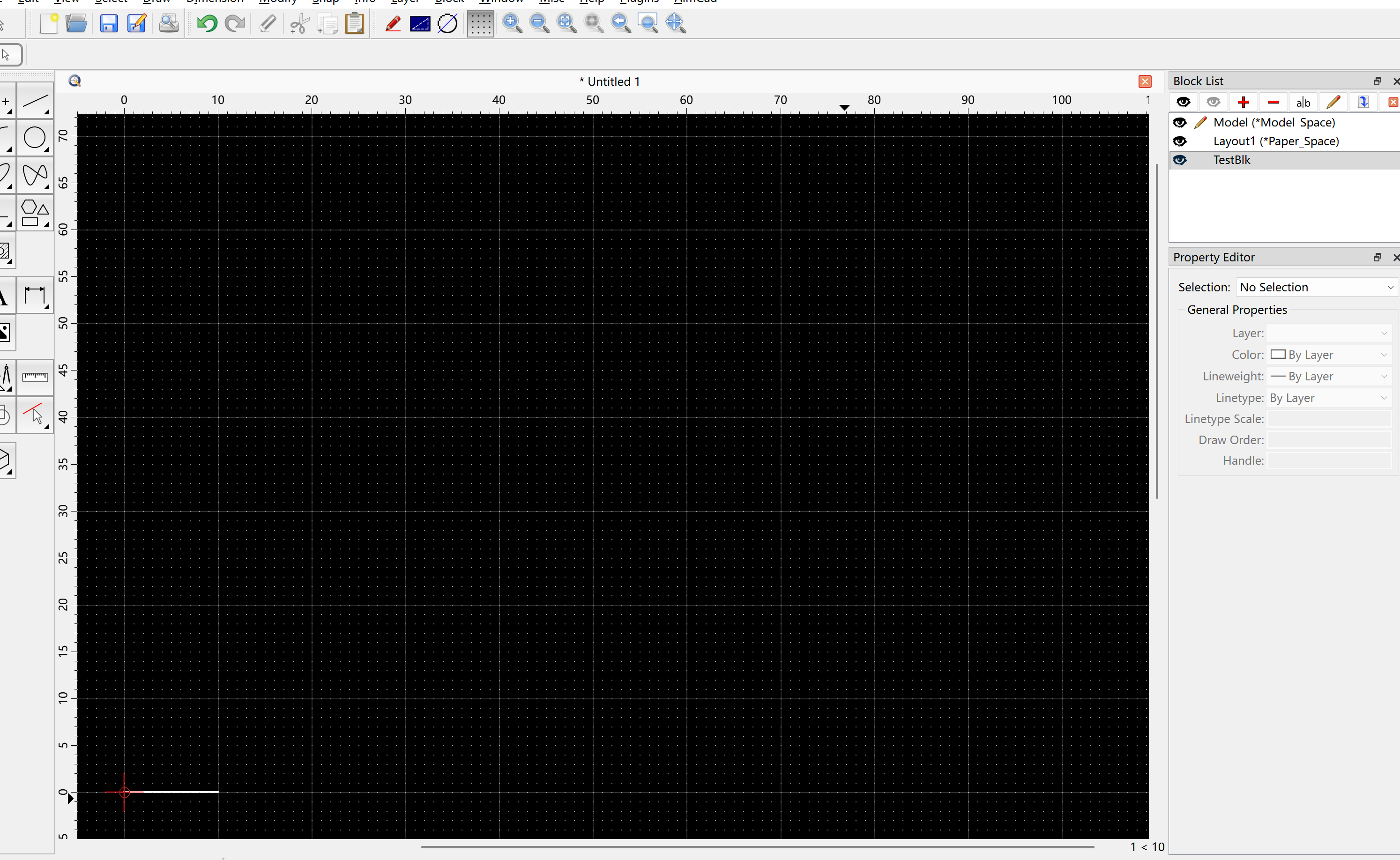

Hi ,there
I am a newbie to QCAD programming.
I want to rotate lines with some degree for learning how to code with QCAD.
So I have given a try to write a simple GUIACTION test programming, but it does not works as expect in QCAD UI ( rotating a line with 90 degree)
hope someone can help me find problems in the code beblow ,thanks so much.

Hi, and welcome to the QCAD forum.
First:
Please include code on the forum in a code panel.
Edit your topic, select the textual code and hit the [</>] button above the text area.
Same for creating a new post or replying to one.
Second:
How do you intend to run this code?
I presume that it is written in C++ and then your sole option would be as a plugin
Perhaps as an RCC Plugin, see tutorial: Creating an RCC Plugin
The other options are a Script Add-on, a simple script to execute (with GE or XC) or a Command Line script.
Scripts are written in ECMAScript.
Also see the tutorial: Script Programming
Not a specialist on the C++ level myself.
If your code creates a Block definition with a line in it and inserts a Block Reference angled at zero rads ...
But doesn't for a different angle ...
:?: Are you sure that M_PI is defined without including something?
