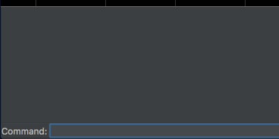

I have made a small change to use the command line as a calculator. Although you can enter expressions in the command line, it doesn't display the result. Also sometimes you just want to do a quick calculation without actually sending the result to a command.
If the first character in the command line is an equals character ("="), then the rest of the line is treated as a maths expression. If the expression results in a valid number then it is displayed in the command line, preceded by an equals character. For example:
=2+2
=4
After entering the expression, press the 'return' or 'enter' key to display the result. As the result is preceded by an equals character you can continue to enter another expression.
If the result is invalid then an error message is displayed in the line above, and the command line is left unchanged.
If you don't want the equals character displayed then add a space character to the end of the expression. The result will then be displayed without the equals character. For example:
=2+2
4
There is a space character after the final 2.
If you want a relative character displayed, end the expression with the relative character. I use the default 'at' symbol (@).
=2+2@
@4
If you have changed the symbol, use that symbol instead. For example:
=2+2%
%4
This can be used at any time in, any command.
